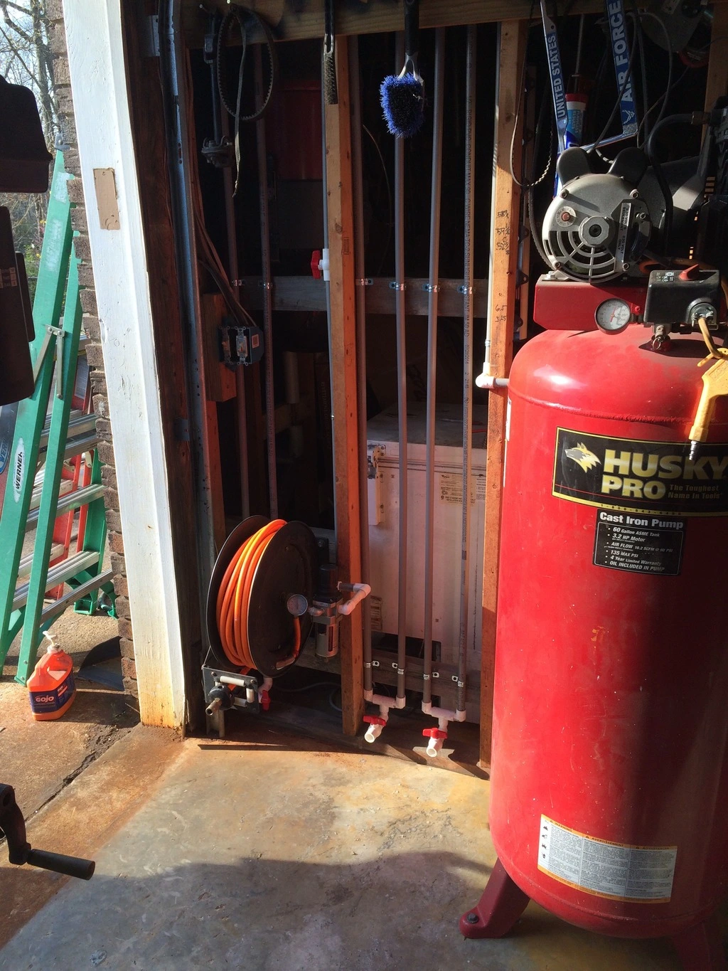

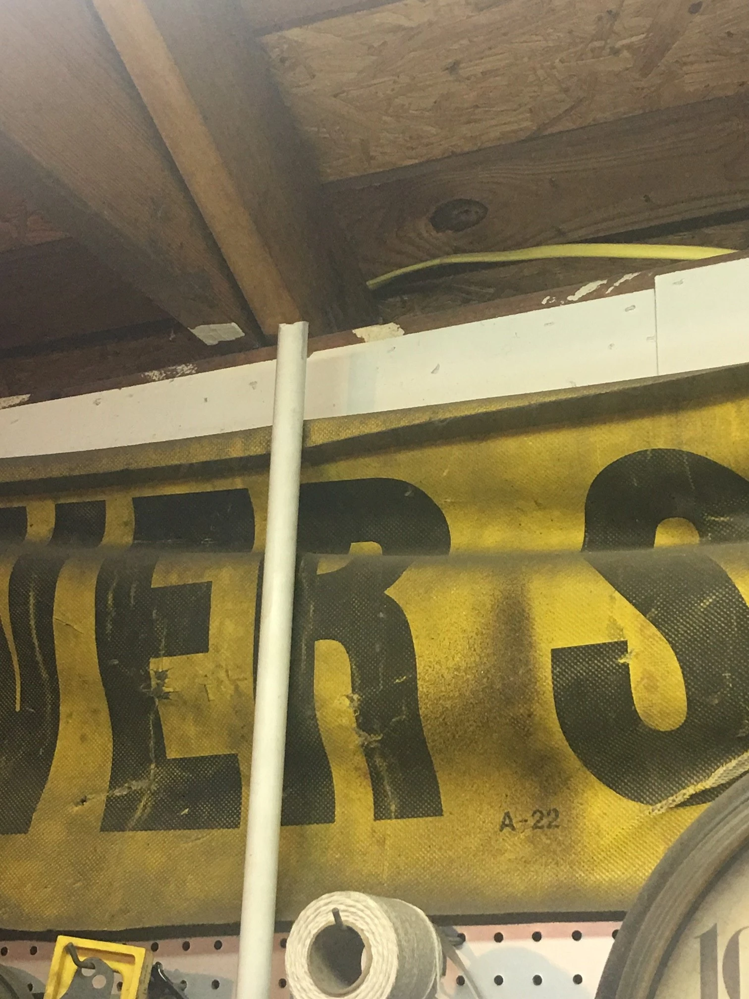

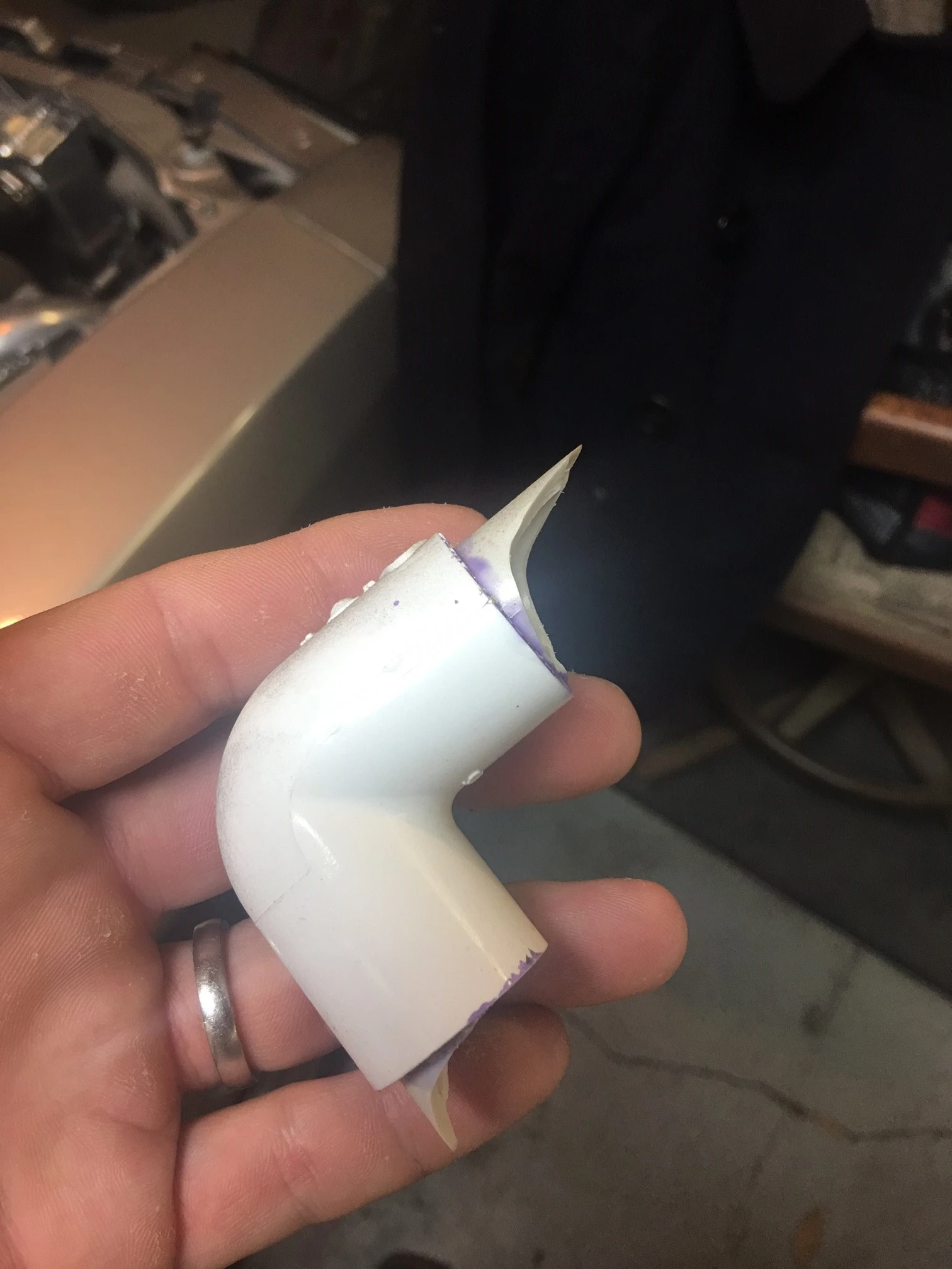

PVC air lines went kaput last night. Air temps in the 60s.

Years ago I was working in a shop that rented space for you to work on you own car and they had a huge screw compressor and pvc lines and 120 psi. one exploded, I mean EXPLODED! Did't hurt anybody but did break a windshield. The place where it failed was in the sun for most of the day and that was blamed for the failure. This was back in the 70's so I'm sure we have better pvc pipe making stuff now.

I just had a buddy send me a picture on facebook of him in the ER - a PVC airline exploded and sent shrapnel into his face and messed him up good.
...Another buddy is an HVAC tech and is donating some copper line to the cause so I can get back up and running.
Reactions: A5literMan
Prob Sched 40 then.
Sched 80 is a bit thicker and take more internal pressure
Yep. 80 will last 9 forevers. A machine shop I worked in for ten years had a schedule 80 pvc header that stayed at 160 psi. No problems ever. The building was demo'd before the header failed.
