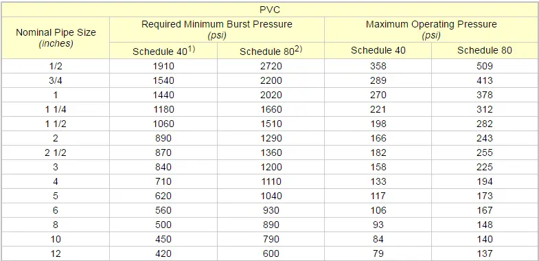

In other news, here's a general chart assuming 79* ambient temperature:
Longer lengths = more flex; you get the idea.

I knew it would hold a lot, but I didn't know it was rated that high. Interesting. I may have to drive up to Collin's house and investigate further..
It's not really that high. Max operating pressure for 12 inches of schedule 40 is only 79 psi (granted, that's a big pipe assuming they're talking diameter).
The reason for that of course, is that it expands and contracts each time it's pressurized. Over time... poof. The burst pressure that you're looking at assumes brand new schedule 40 PVC and not so much PVC that's seen pressure rises and drops over a period of months or years.

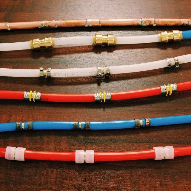

Shark-Bite plumbing or something similar, would be better as air-supply piping I'd think (never tried it for air).
Of course it's going to be lower for 12 inch diameter pipe, the surface area to psi ratio is insane. Why the hell would you run 12" diameter pipe? 3/4 is as large as you'd ever need to keep your volume and at sch 80 its good up to 413 psi. Show me a shop compressor that can put that much pressure up and I'll kiss ol' spot. Something caused that pipe to rupture be it fatigue from mounting, vibration, heat, UV, something.
