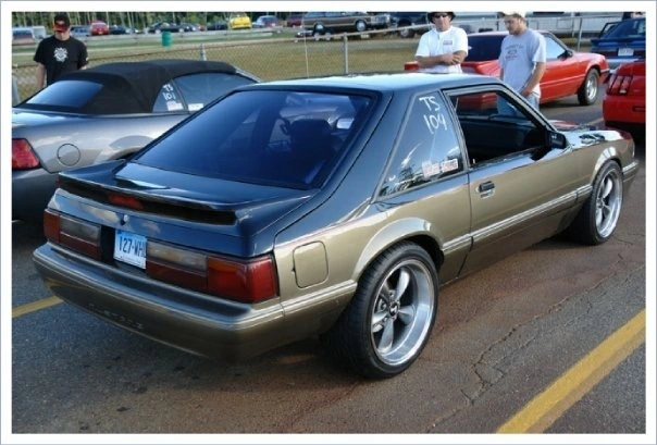

I have 4lug deep dish ROH ZS wheels on my 93GT
front 17x8.5" 235/45/17
rear 17x9.5" 245/40/17 quad shocks removed
Can't remember offset, but no rubbing issues.
