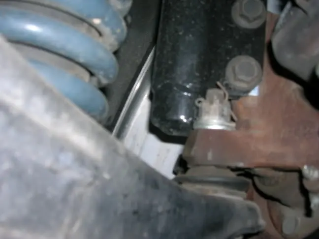

i also have the 96 setup.no problems here.the only thing you need to do is when you put the lower castle nut on the lower ball joint,you need to put some grade 8 washers to bring the nut up to ues the cotter pin,because the 96 and up ball joint are shorter that the foxes.i cant remember how much you need to bring it up but its not that much.im gonna try to post a pic to show you the washers. other than that everything else bolts right up .

Jozey's right, if I'm not mistaken it needs to be .330" thick, at least that's what some site said. Goodluck!
yea i think it around that size.as for the lower ball joint you use your fox body one.you dont swap them out.to much of a pain in the azz.just do those washers and your good to go.
