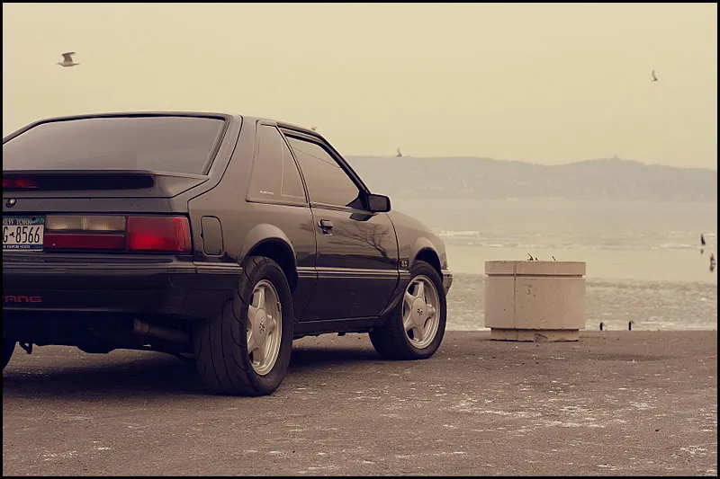

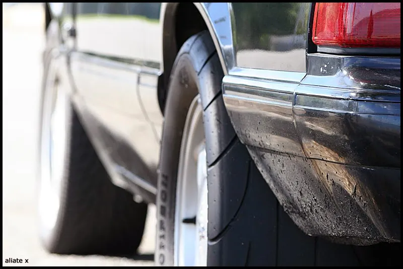

255/50/16 MT ET Radials.
They dead hook with 5500 rpm dumps on the track, so much so that the car was nosing over even with 4.10s. On the street they hook awesome as well. Better than my 275/50/15 nittos ever were.

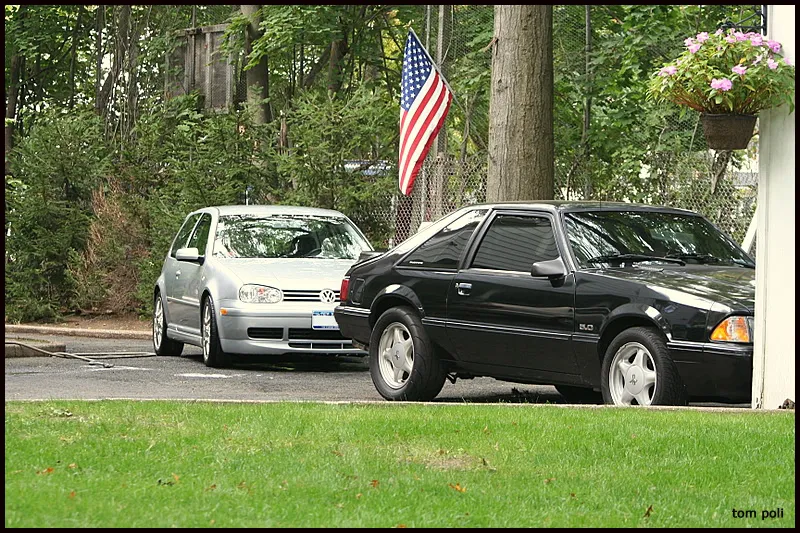

I have them on the rear of my '88 LX as well. BFG g-force KDWS. Slight bulge but that's because a 7" wheel is about the narrowest a 245 should be mounted on. I have C springs with Koni reds set on soft and the ride is fine (yeah, I said in another thread that Cs were too harsh, but not after I fiddled with my Koni adjustment), confident and fairly comfortable.
