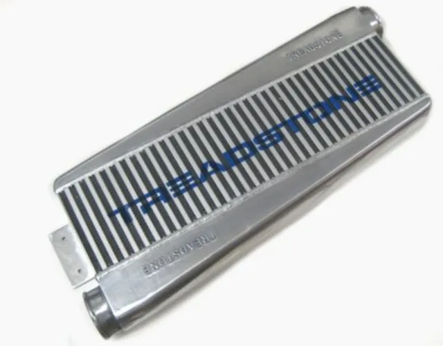

Hey what do you all think about top to bottom intercoolers like this one? I read that they are supposed to have less pressure drop and cool more effectively. All of Prochargers intercoolers are of this design.
