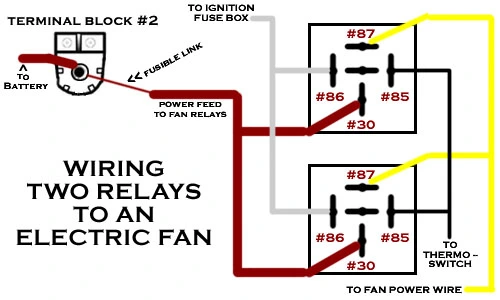

Each relay has it's own 35 amp fuse, they are located in my fuse box I built under the hood.
Is this the correct way to wire them if I go the 2 relay route like you?
Are these relays sufficient if I pick up two and wire them in parallel like you suggested? Amazon product ASIN B01KFKEFZAView: https://www.amazon.com/gp/product/B01KFKEFZA/ref=ox_sc_act_title_2?smid=A180VU3KH6ZVF2&th=1

Thanks! Does the fuse on the relay board alleviate the need for an additional fuse between the relay and the battery/solenoid? If so, that might push me in this direction since it would save me having to get a fuse holder to put in between the relay and battery/solenoid.

yes and yes

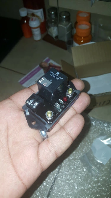

The board has a designated place for a fuse. I use a 40amp fuse on mine. I'll see if I have a pic of mine with the fuse on it. It's not a regular blade fuse.

I couldn't find any pics of mine with the fuse on it so here is a pic of it and a pic of the type of fuse it uses. the fuse goes on the 2 blades right nest to the LED indicator light.
This is the kind of fuse it takes.

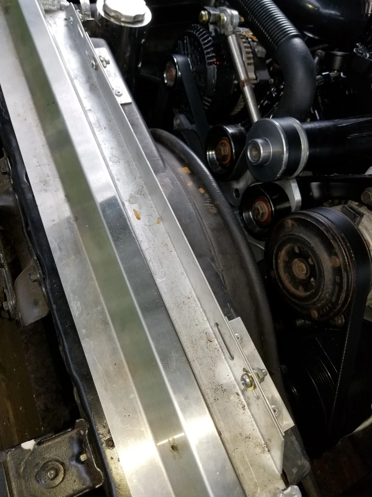

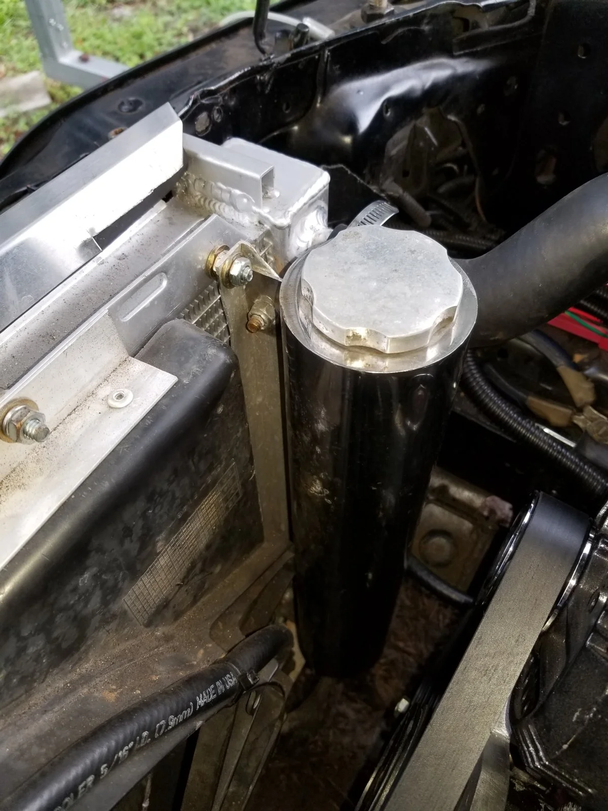

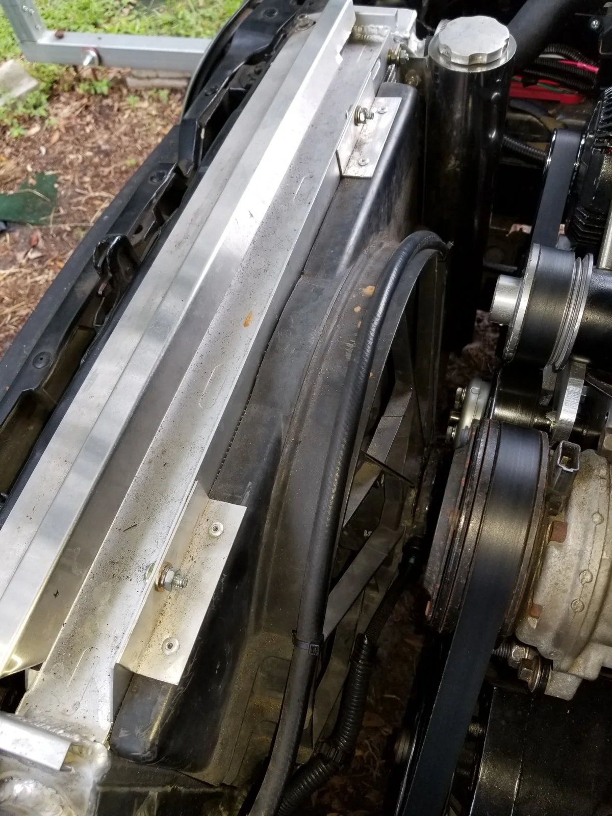

I trimmed the shroud down and used aluminum angle to make brackets, I riveted the brackets to the shroud then bolted it to the radiator. I will get some pics.

I am pretty sure the shroud was large enough it hung all the way to the bottom of the radiator, I used large zipties on the bottom side.
The rivets were long and I used washers on the inside of the shroud so they could not pull out.
