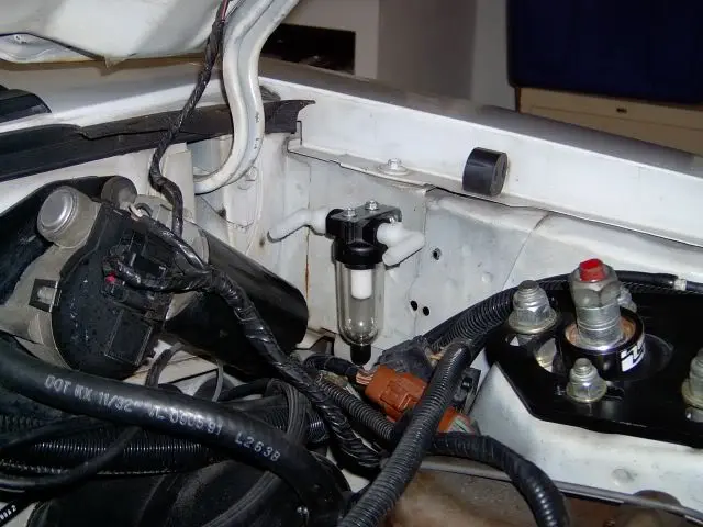

Mike, I used 1/4" NPT fittings with 3/8" barbs for the hose (I used fittings that turned 90* for a cleaner install since my separator is high on the firewall). I used hydraulic hose since I figured it wouldnt kink but fuel/Evap hose should work fine and is more mallable.

Got the separator from Home Depot. Cost a whopping $11. Here's a pic of it mounted with my home made bracket. All I need now is a motor to connect it to...
