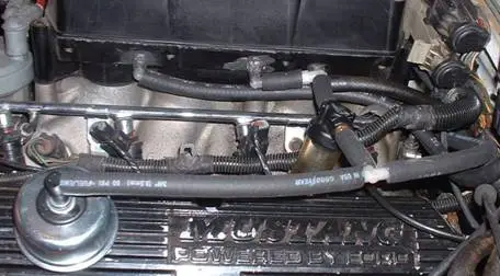

I have been talking about posting pics for several weeks now, so I guess I should follow through.
blackcloud50 said:
With stock style valve covers on a 93 where could I mount a second pcv? Any ideas?
As I see it the main issue with mounting a second pcv on a Mustang with a stock style (long runner) intake is getting the pcv to clear the over hanging upper intake plenum. If I tried to use a stock style intake, the plenum would be riding hard on the breather/pcv cap I installed.
I have been trying to come up with an easy way to run a second pcv with a stock upper intake, but have not had any decent ideas.
There are many smart dudes here though.
Maybe someone else can find a solution?
jason
