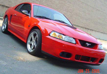

Mine are 255 in the front 275 in the back. i love the way it looks....
I think the car stock has the front wheels are rear wheel offset a little so the car will not tramline.
you just notice it more now that you have a 9" rim up front. I got 9" front wheels because 8" was going to be 8 weeks out. I notice the front to back offset more now.
you can run an 8" rim up front or put a small wheel spacer out back. I am not sure if this will make the car tramline more or not as I have not dont it. I don't really mind it.

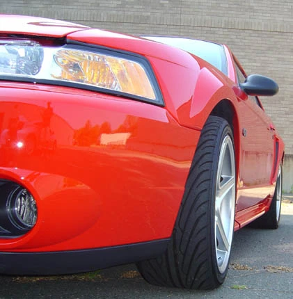

No offense guys, but those pics suck. Can someshow a pic more like this one..... but from the front.
In this pic you can look down the side of the car and see the edge of the wheel lip and it's location in relation to the wheel/tire combo. BTW - this is my '90 'vert w/ new wheels/tires
i had the same problem when i was running 275/35/18 nittos all around. I didn't like the look but i had already paid for the tires and mounting etc so i lived with it. I recently bought new rims so i went with 8.5 in the front with 255 tires and 9.5 rear with 285 tires and the look is great. The front is flush, and i could get away with a 295 on the rear with no problem......I just think 275 is too wide on the front if you don't want it to stick out.
i'll take a pic when i get home from work.
Here's mine, 18x9 front 18x10 rear. It did look funny when it was stck hieght.. You might just want to put some spacers in the back so the rears match the fronts.. it's not really sticking out that far, it's just the way your perceive it with the rear fender and the stock height.
