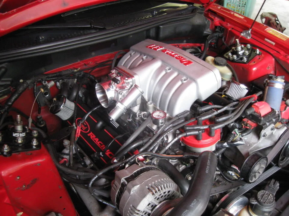

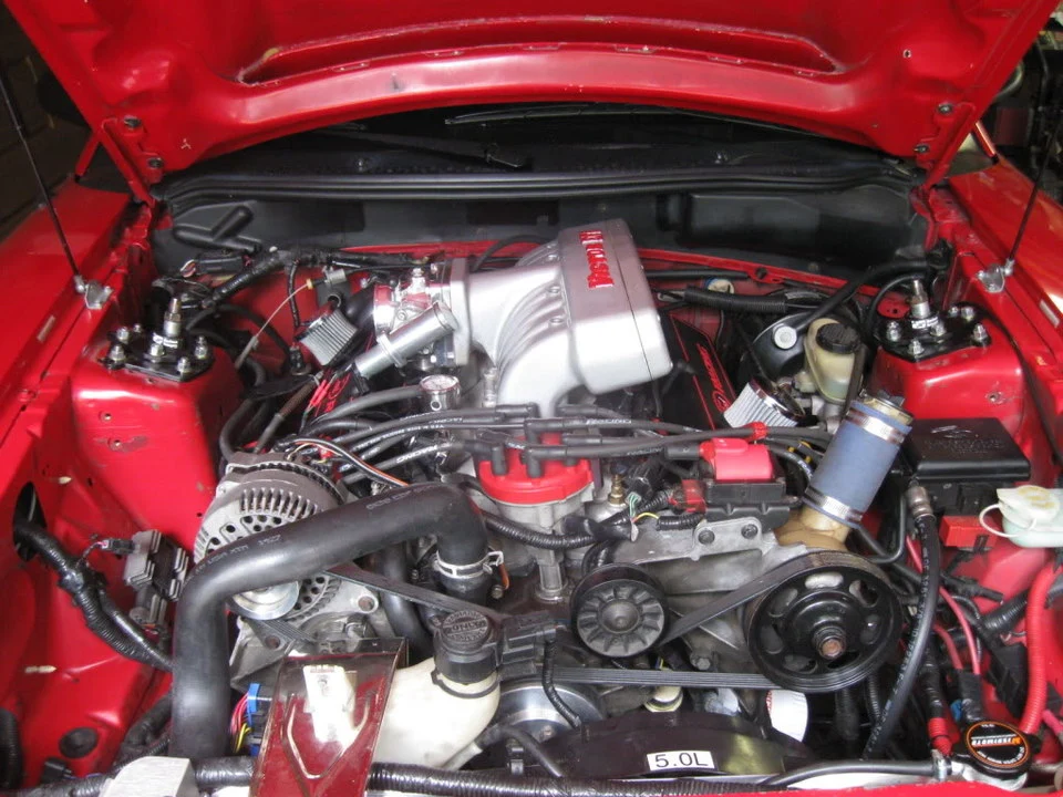

They only made that TB design for 2 years. I hate looking for 2 year specific parts. BTW i run a 90mm Accufab TB with an EGR delete plate. Also i feel the fox setup is alot more simple and mechanic friendly.

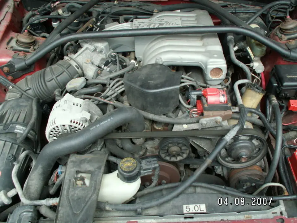

My first priority when i got my 95 was to clean up the cluster f#$% mess of an engine. It looks crammed and tossed together. I now have more engine bay room with my 351 based motor than i did with the 302.
Not that it matters buuuuut.....I can also remove both valve covers without touching my upper intake. :)
Before
After
