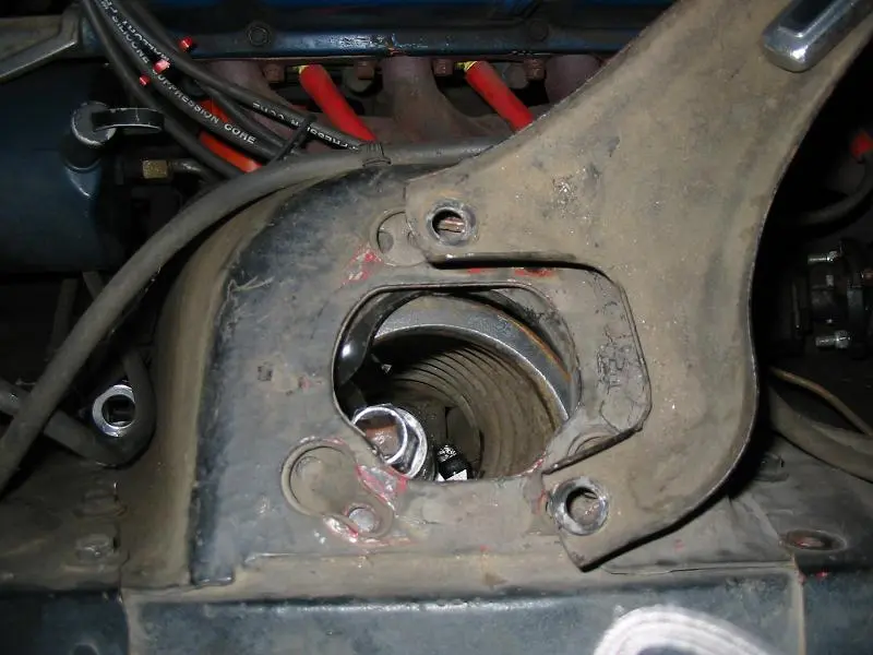

So I am getting back to Granada swap project on my 68 coupe that I started a month or two ago. I finally decided to put in some 620s springs just to hopefully level it out, and this would be a good time to do it seeing as how most of the front end needs to come off anyway. I am aware that the springs don't have to come out to do the swap, but it's too late for that - here's why:
To remove the springs I started with the outside type compressors, but I really don't like how they have a habit of spinning around next to each other and launching the spring through the garage wall (my dad did this years ago - glad he wasn't in front of it!). So I went and picked up an internal one tonight, and then I learned that they can slip too! While you are pulling the spring out. With your hands. Thankfully I still have my fingers!
As you can see in the photos, the spring is now sort of lodged underneath the insulator, with the bottom of the compressor not entirely on anymore. I am kind of freaked out about how to get it out now. I was thinking of putting the outside compressors on and see if I can recompress it enough to get it out. Or I remember reading about someone using a torch to heat the springs up and have them "fall out". I've never tried that and the whole "spring shooting through the garage wall/my face" has me a little worried.
Anyone have any suggestions? Other than "Man up Nancy!"? Will the torch idea work?

If you torch the sping it will just collapse and ruin it. If thats the plan, just be sure not to melt through. I would try to get the compressor to work. If you cant use it to get the old springs out, how will you get the 620s in? Its also not a bad idea to lubricate the threads of the compressor with some moly grease.
I'm going to do the same thing in the near future. I got some 620s to compliment my 1 1/8" swaybar and Granada discs will go on at the same time.
It looks to me that the center bolt is too long and is now being forced against the shock support on the control arm. Try backing out the screw and it should relatch.
Most inside spring compressers have a bolt that is too long for use with a mustang. When I bought mine, I also ordered the optional shorter center bolt too.
If you find that the bolt is too long, either shorten the bolt if it is yours (hack saw job) or take it totally apart and stack several large washers under the big nut on the top. Then reassemble. The washers will take up excess length.

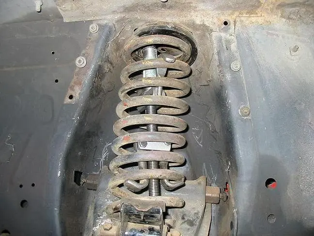

It looks like it is hitting, but it actually has about 0.5" to go. I read about this issue in another thread, so I used a 3/4"x3.5" piece of galvanized pipe to take up some room. You can see it in picture two if you look close.
Thanks for the advice all, hopefully if I still have my fingers this afternoon I can post a follow-up.

I got it out finally, with only the outside compressors on.

It turns out that was the problem. The bolt head was sticking up above the spring and hitting the sheetmetal, which wouldn't allow it to come out. I ended up taking the internal compressor out, and smacking the spring with a hammer until it popped out. The outer compressors stayed on the whole time, even after rotating to one side.
Once that was out, the new (old) spindle went right on. Looks like another month long hiatus though - I gotta go out of town tomorrow for several weeks.

I did it like you are doing it, except, I used 4 of those pipe fittings. It looks like you are using 2. Might be worth it to undo it, and throw another 1 or 2 on.
I tried several ways, then I finally came up w/ the pipe fitting idea and I was able to get my springs off in about a minute.
