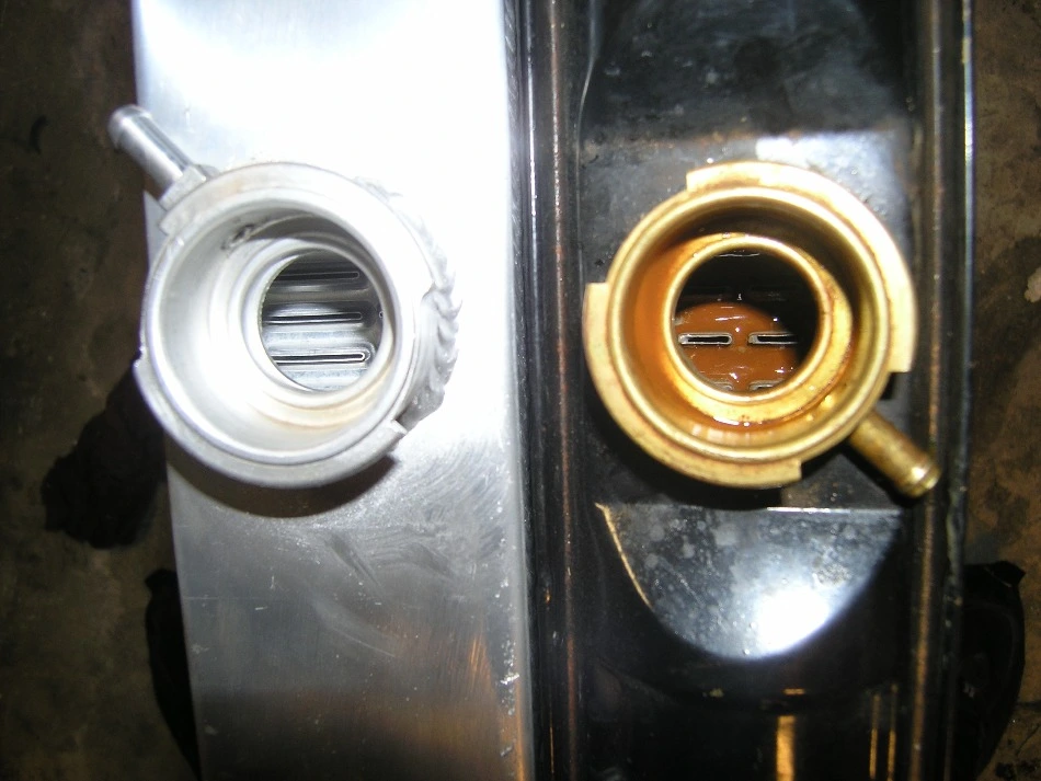

FYI, I had purchased an autzone radiator. It was a 67 radiator that I installed into my 66...the 67 radiator is 4 inches wider and should have colled pretty damned well.
it didn't. The temps instantly crept up and up and up, even in 50 degree weather at a stop light.
I took it back, and got the below radiator. The rad on the left is a 2 row generic ebay radiator, but it kicks ass. In 90 degree weather with NO fan shroud it won't go past 205 with a 195 tstat
