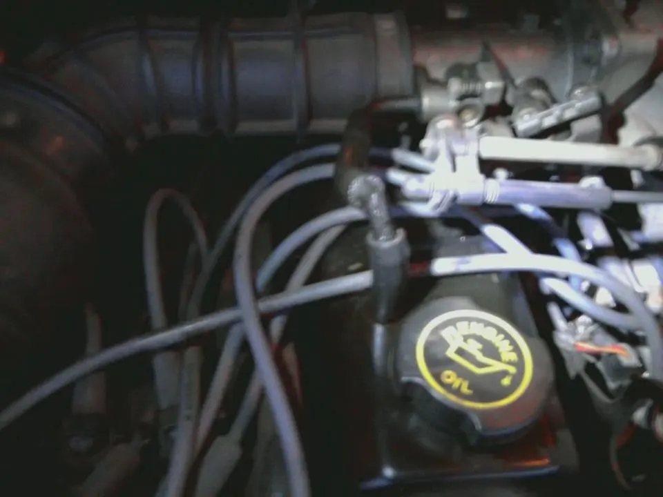

Why is this saturated?
SMOKEDYA
Jul 13, 2003
3,637
79
Tucson AZ
This is on my 4 banger and sorry for posting in here but no help and lack of activity in the 4 banger section.Anyways why is this tube so saturated in oil?Or is it not a big deal?peace
john:p
yep, the pcv/separator can get plugged up on these.
Look for both of them under the lower intake manifold, coming off the block...
It's an issue in that it indicates that your crankcase isn't venting properly. this affects ring seal and gasket/seals...
