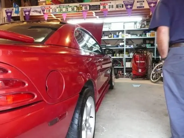

Im running an H&R 1inch spacer, with 275 BGF sport tires, on a 17x9 rim, and if i bottom out or even close to it, the lip on the outer fender cuts into the tire, bad enough that it concerns me, i am going to have to get the lips rolled this spring.
I have no idea how you plan to stick a 345 in there, spacer or not

I run it for the looks, when i put the cobras on, you could cleary see the front wheel face sticking out further than the rear, looked like serious ass, so i put the spacers on asap
