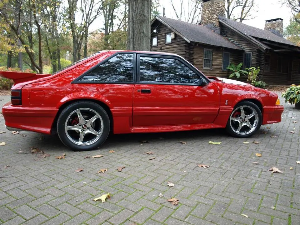

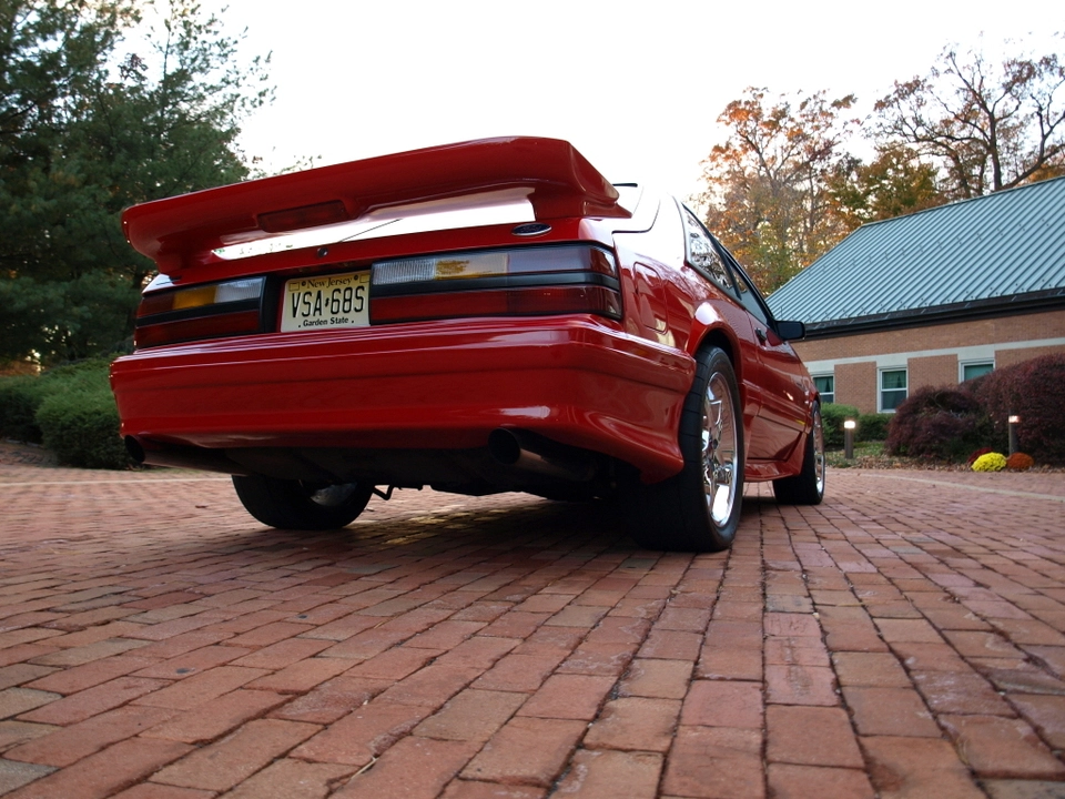

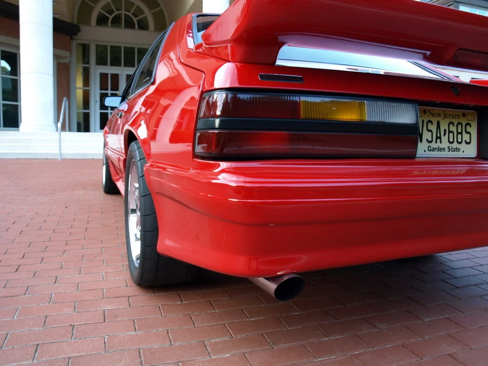

Scott is on the money Im running 17 x8 wheels with Nittos 555 DRs 275/40 in rear they are skinnier than Mickeys and most other DRs by almost an inch in some cases. This is mainly the reason I originally bought them. Now i know Mickeys will fit also but like Scott says the Nittos have hardly no bulge i like the way they look, ive seen Mickeys on same application and it was a little too much bulge for my taste. Also quad shock will not rub, on front im running 245/40
heres some pics
