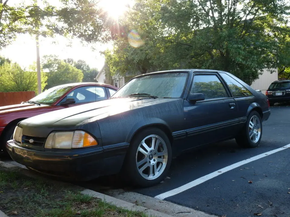

I'm not a fan of the 'fanblade' wheels, but I really like the 10 spoke 17s on the GT. They look a bit odd on that black GT, but I think they look fine on my fox:
