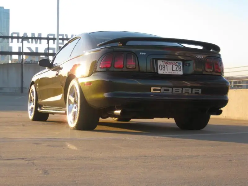

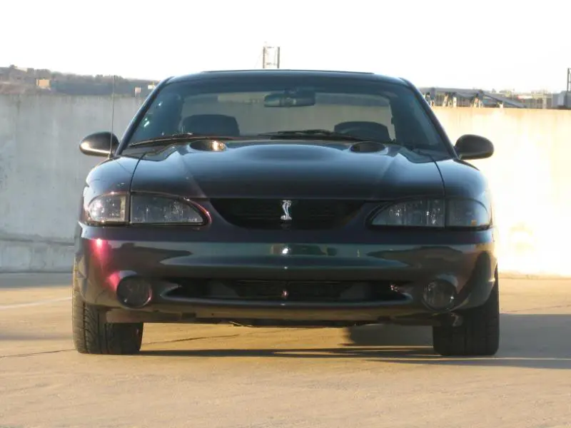

275's will fit just fine, & alot of people run that size on 94-04's, but I personally didnt like the look on my old 95 GT. They looked like the front wheels stuck out with a 17X9 & 275/40/17 tire. I even had 17X10.5's with 315/35/17's in the rear, & the fronts still looked like they stuck out more than the rear??? Its very common on 94-98's though, since they have a narrower rear end than the 99-04's.
I would run a 255/40/17, as they will fit perfect on the wheel, & should sit flush with the fender lip...

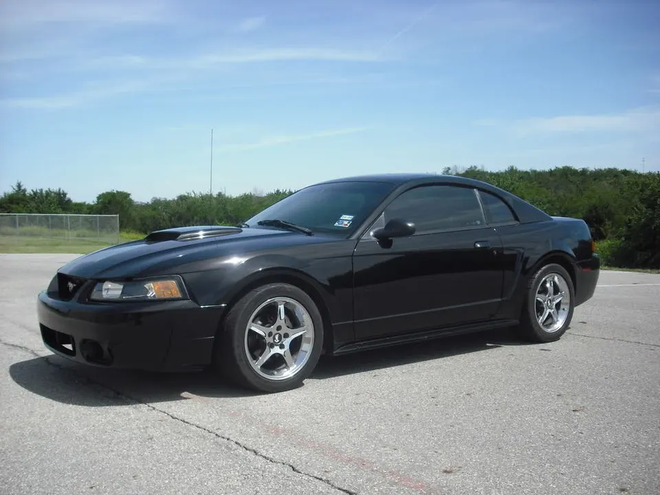

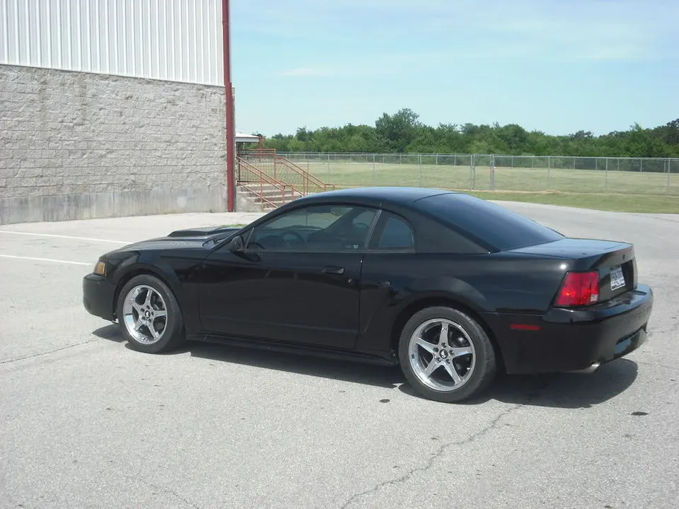

I just got a OEM setup off a 04 Cobra (chrome 17x9's and 275/40/17's). From what I can tell, they don't rub. I'm gonna have the wheels off sometime soon and I'm gonna check to make sure. The ONLY reason I have 275's is because I can still rotate. With you having 10.5's rear, it isn't a big deal. Epic said it well, stick with 255's. I feel that the 275's up front stick out too far, as mentioned. It's hard to tell from the pics, but here are a couple to show the 275's up front.

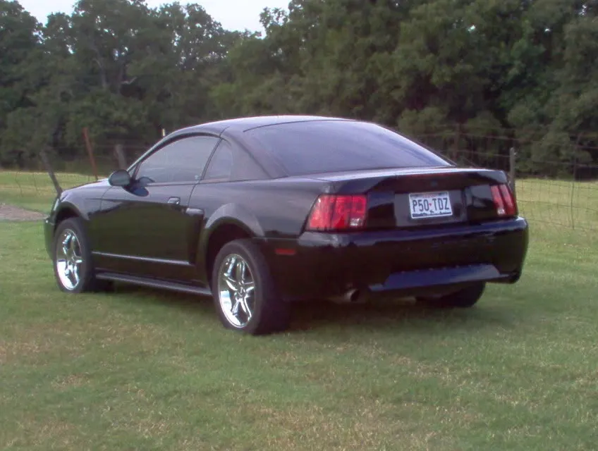

Here's my buddie's 01 GT. Sorry, but I DO NOT think 275s are too fat for the front. This car looks good.
275/40/17 on all four corners
They look just right on a 9 inch wheel, any more narrow, and the sidewall goes in too far, any wider and they pooch out.
