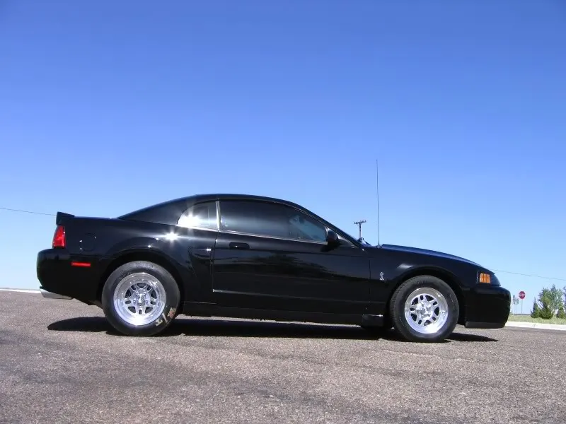

Do you want a lightweight drag wheel because you plan on drag racing the car, or do you want one just for the "looks"? Personally I'm just not a big fan of drag style wheels on a street car. To me they just don't look right when seen on a car driving down the boulevard. Now if you are actually at the track racing the car it's a different story. This pic looks good to me at the track, but not on the street...
Bogart D-10's
