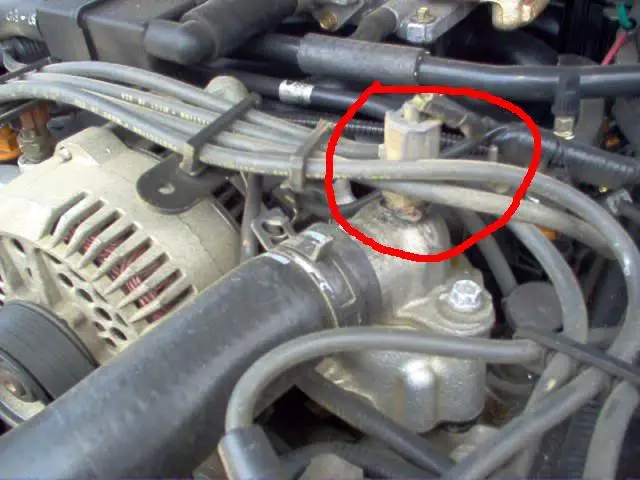

If it is the all plastic intake, I am not sure where you can put the other sensor. NPI cars have 2 temp sensors, PI cars have 1. If it is the aluminum crossover, just tap and drill it for the heat sensor.
tomustang said:
Or you can just get a T fitting, no difference and ALOT easier.
:nice:
Or the Vax way
