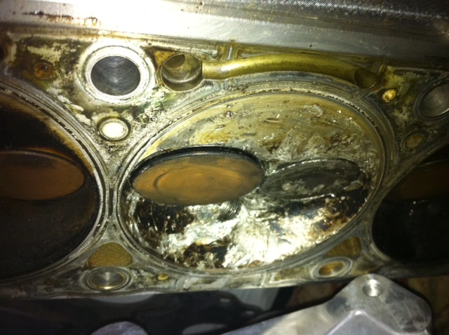

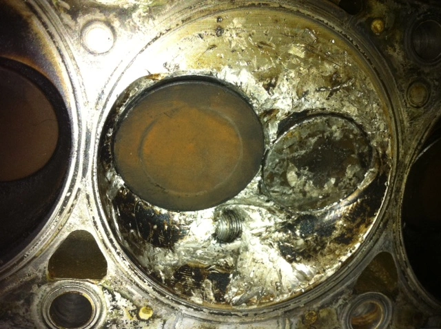

HERE ARE SOME PICS, SALVAGEABLE? ANYONE KNOW WHERE TO HAVE THEM REPEARED IN CENTRAL FLORIDA?

Only one...He said that the valves werent properly lubed when put together. It really doesnt seem too bad but how much do you think a shop could charge to fix it? Like I said its only one chamber and it looks like they would have to fill it in then grind smooth.
Something like that is subjective, the price is going to vary depending on who you take it to. I would really do my homework on whoever you get to repair it and dont just go with the cheapest price. Id bet that you have some other bent valves there too.
I think by the time you are done with the heads you will have a minimum of 1k into them.
