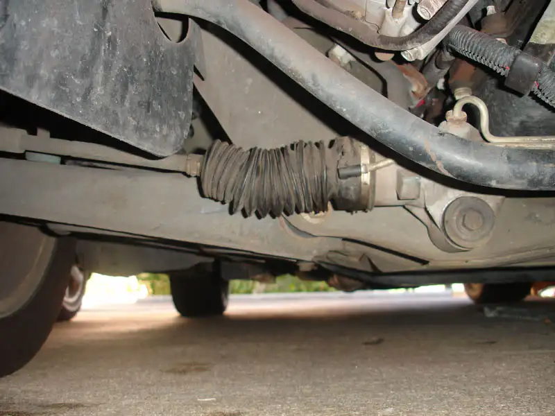

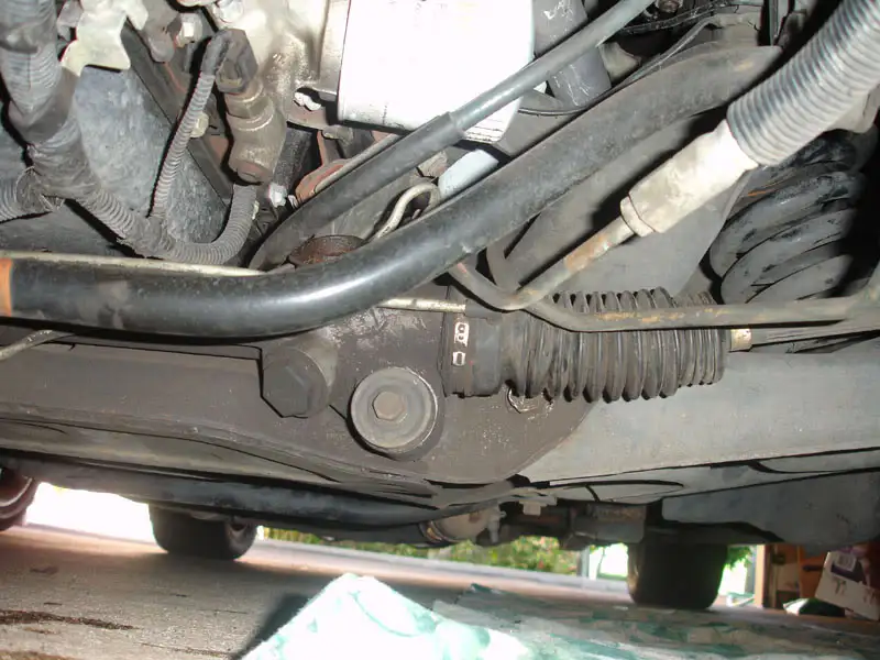

what boots are torn.. the inner tie rod boots that attaches to the steering rack or the outer tie rod boots that are between the steering knuckle and the outer tie rod joint.
I would get new boots if it's the inners and you will not need to put lube in there. if it's the outers just replace the tie rod ends themselfs

those boots, im assuming those are the inners. ive been driving like this for a good 6 months, and i'd feel better if I added some type of lube. What's recommended?
