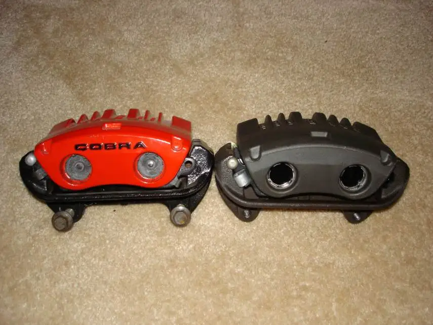

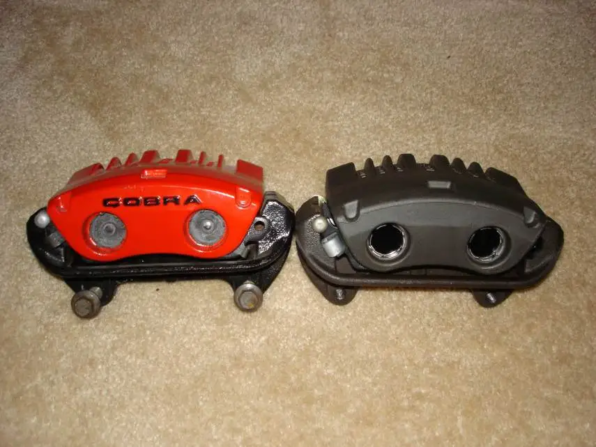

The brackets are part of the caliper on the front brakes. You can see the two bolts on the caliper to the left. You bolt it to the spindle here
Both kits are complete. Not only is the buyfordracing kit cheaper, but it comes with stainless steel lines while the mustangtuning kit comes with OEM 99-04 brakes lines (which you would already have if you own a 99-04)
Only thng you need with the kit is brake fluid

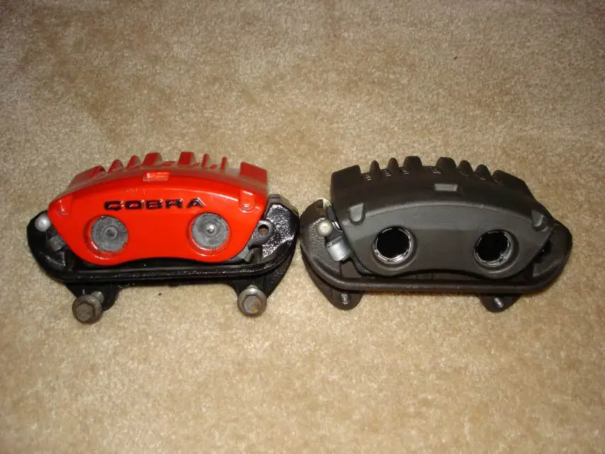

I dunno. I've seen guys do it but i think it looks better if only the caliper is painted and the bracket is just left black.
But it's weird because for my rear calipers, i originally did the same thing and left the bracket black, but i didn't think it looked good so i painted them completely black like the Ford OEM rear calipers
