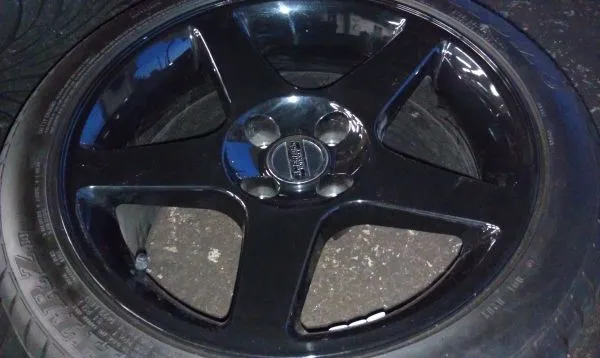

I found these for sale on craigslist, I have an 89 lx. the rims are 17x9 and the tires are 275/40z/r17 He is asking 600 I know the bolt pattern is right, but will they rub or have other issues?

They should not rub at all in the rear. The front...meh...a friend of mine ran 17x9 with 275's up front and the rim rubbed on his coil over strut. It might clear a stock strut. We simply ran a small spacer on there...problem solved. Get him down to 400 or 450 tho.

we settled at 450 im going tomorrow. thanks for the help

Rears should clear by a mile. Fronts may rub depending on the ride height.

Will these stop the front from rubbing? Can i use these on stock lugs?

Inspect those Sumitomo tires really well before buying. They are real bad about seperating. Not very good tires at all. Expect to change them sooner than later.

the front center caps wont fit over the dust cap

Guess you answered your own question. No, they won't fit.

You can try a spacer up front to get the wheel out just a touch so you can maybe get the center cap on. I have no clue if this works, but it's just a thought I came up with and may try with my car.

If I get a spacer, will i need longer studs?

Will it fit without the dust cap? In other words is it the dust cap or the diameter of the center of the rotor?

Just depends on how big of a spacer you get. I would say that you don't need longer studs on something like 1/8" but 1/4" you may want to. As I said before, I have no clue if this all works out. So, if you try it, let us know lol

Anymore than 1/4 spacer your gonna need hubcentric
