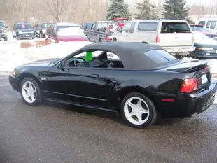

Will these wheels work with 5 lug rotors,(I know some wheels dont) or do I need to get sn95 spindles?
pics of the wheels I would like to used (stock 17s of a 01)
thanks
Zack
They will not work. They will bolt on, but you won't be able to put the center cap on.
I've seen a guy cut a circle in the middle of the center cap for the spindle snout to stick through
