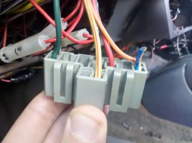

As topic states Im in the middle of trying to figure out the turn signal issue, but before i go buy a new relay and really get into it does the factory dash need to be plugged in?? My car is a 87 lx notch orginally a 4 cyl converted to a Ls1 with all aftermarket cobalt gauges... I just got the car last week and am fixing the electrical issue... THanks
bought a relay.. still nothing... #5 fuse is good... 1 wire however is cut on the harness going to the steering column / turn signal switch.. its a blue and orange wire that is cut.. on the biggest clip closest to the switch
You don't need the cluster hooked up to see if the signals work. You should be able to light a 12V bulb from the signal wire with the other end of the bulb grounded. Does your flasher in the fuse panel work?
fuse panel doesnt have a flasher in place...
I'm willing to bet that your wipers don't work on "high" either. That blue/orange wire goes to your wiper motor switch.
The plug on the top of the steering column (the biggest one) is for the turn signals. Your signals aren't going to work without a working flasher in the fuse panel.
