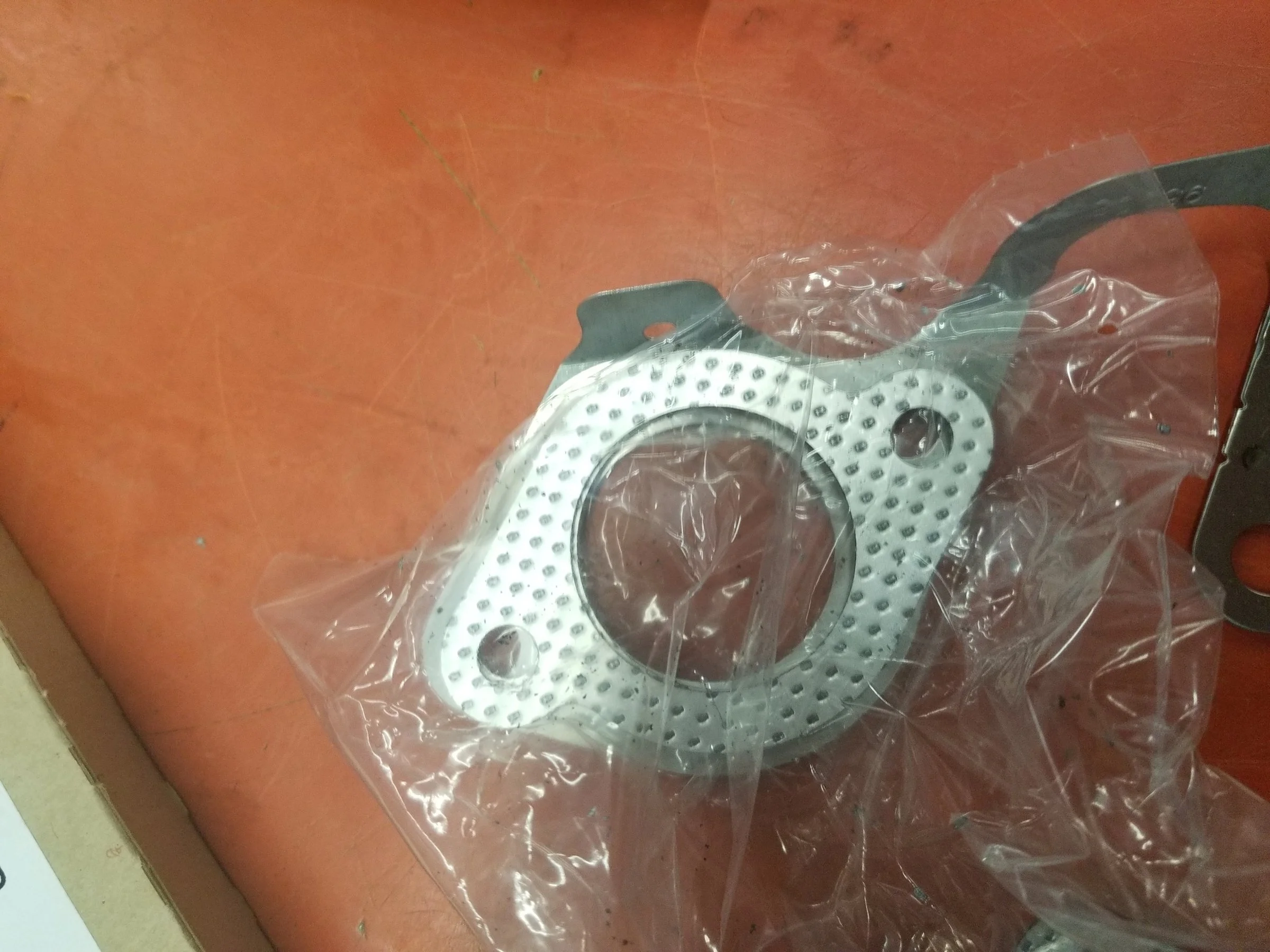

There has been some interesting revelations the gt gasket (on top) the v6 at the bottom it sure looks like I can get away with using the gt flanges for my v6 manifold
