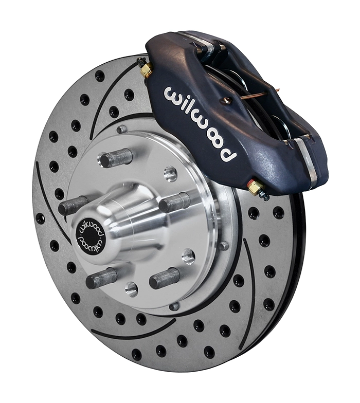

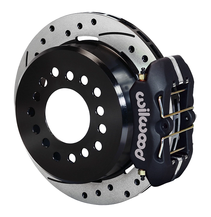

Does anybody have experience with these Wilwood brakes (11 in rotor front/ 11 in rotor rear) versus the more common Cobra swaps with 94-95 spindles? I haven't found any Foxbodies that use them. I was considering these along with the Square 18x9 Saleen wheel package from LMR. Any thoughts or pictures would be appreciated.
http://www.wilwood.com/BrakeKits/Br...&model=Mustang&option=V-8+Spindle+Only,+5+lug
http://www.wilwood.com/BrakeKits/BrakeKitsProdRear.aspx?itemno=140-11396-D

While I don't mind wildwood products (I actually like them, you get a lot for your money, usually), why would you want 11 inch brakes with 18 inch wheels?
The brakes are going to look just as small as the stock 11's. Which I know from experience, looks way undersized.
Also, once you goto all custom parts you don't have simple off the shelf solutions in the future for repair or replacement.
