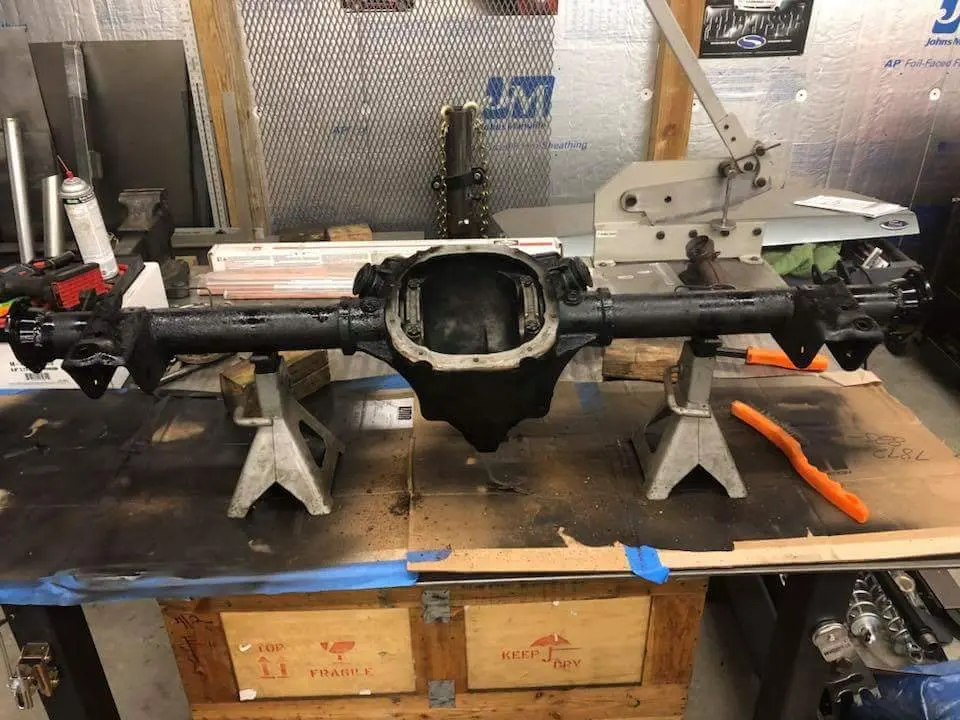

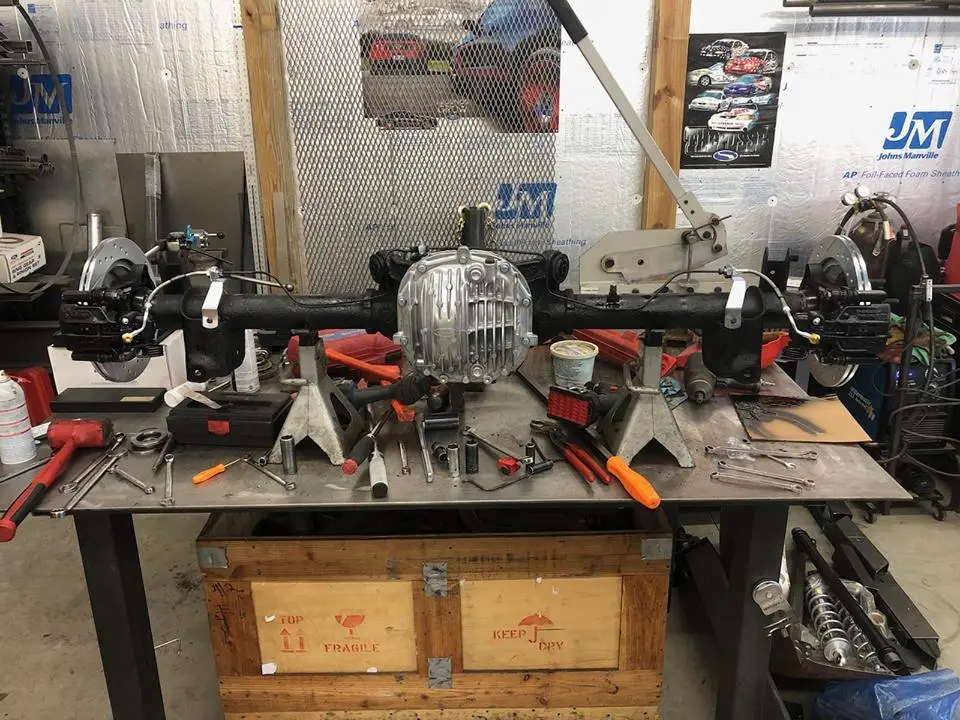

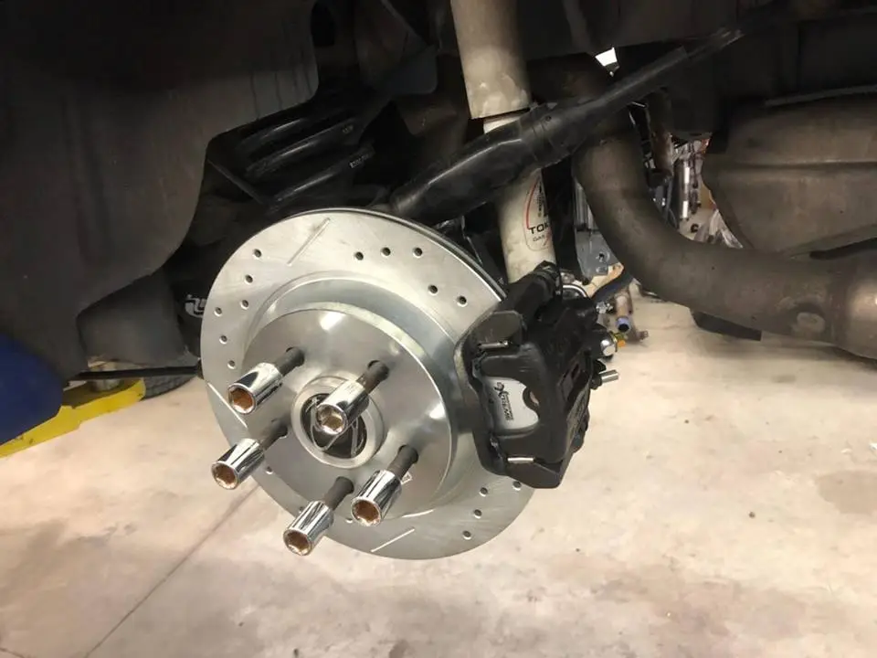

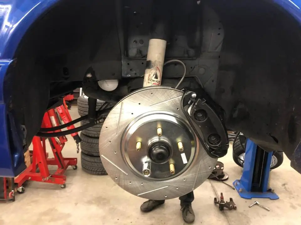

Final Plans have been made with builder. Front: 94-95 spindles, 94-04 Cobra Brakes, Stainless lines, 13" Slotted/Cross-Drilled Powerstop Rotors (I know, they're pointless and I should go blank, but they look pretty!) and Rear: Strange Engineering Brackets, 9" housing ends,Strange 28 spline Axles, 94-04 Cobra Brakes,11.65" Slotted/Drilled Powerstop Rotors, Stainless Lines, 3.73 gears. Of course I'll have the 93 Cobra Master cylinder, Prop Valve and all other odds and ends as well. Should be perfect for what I'm looking to do.

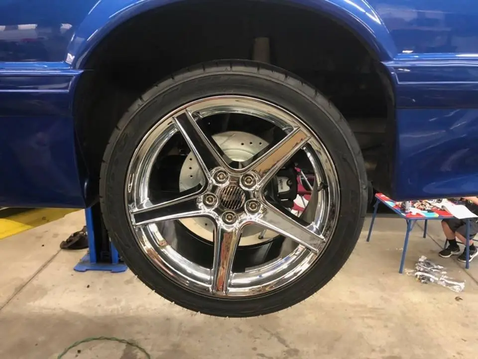

Car is just about done! Still need to get E-brake working properly, an alignment, and perhaps play around with the bias.
Nice man, I just finished up my swap and I like it so much better. I almost went with that same diff cover but then read someone’s somewhere post that they had trouble with dealing due to bigger gears. Idk what you are running but didn’t seem to have any issues. I just cleaned up mine and all the rear and I like it. Maybe another time I’ll make the diff cover change.
Thanks. Yeah, I haven't been able to drive it much yet, but It felt nice for the couple of miles I was able to driving around.. Pedal is a lot harder than it was before, so it'll take some getting used to. I didn't notice any Diff cover clearance issues with my newly installed FMS 3.55s. I should be able to really get everything tested out properly once it's aligned and my E-brake is all fixed up.
Why is your pedal harder than before? Did you not change out your master cylinder and booster?
