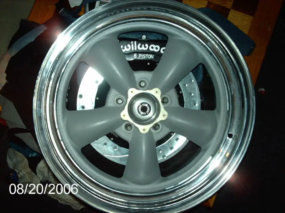

I am pretty sure you can, I can find out for sure tomorrow for you. I have Cobra Automotive's "Big spindle" which I pretty sure is the large bearing 70 spindle. I also Have the wilwood SL6 Big Brake Front hub kit for a 1971-1980 Pinto 1974-1978 Mustang II Part No: 140-7018-B. Ill give CA a call and find out what spindle it is for sure, I can't rember off the top of my head. So I would figure you could do the same just with the different kit.
I have to keep digging, around i know i have better pictures of the whole setup.

What size is that rotor and what size is the wheel?
