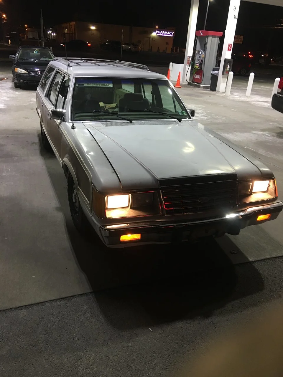

I meant to add more to this. Yes, the ports don’t matter to the water pump when the backing plate has round holes. The ports DO matter to the gasket and both new water pumps came with the wrong gasket for my timing cover. I am at work right now and the Daddywagon powered by a 351 windsor made the 32 mile drive. So far... so good.
Here’s a pic from last night’s test drive.
