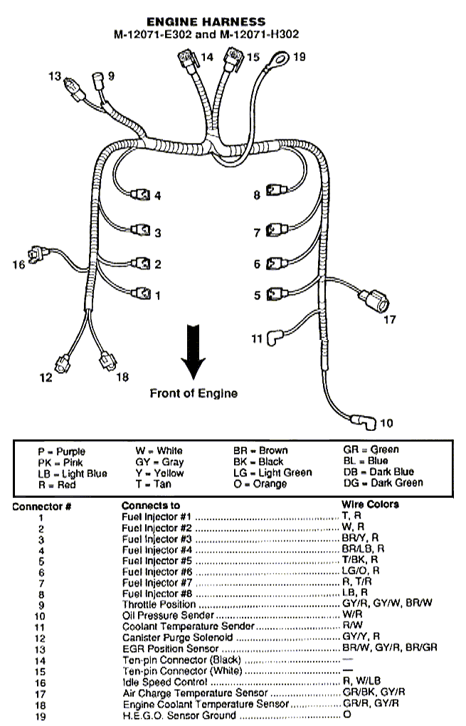

Hello stangnet, i have questions about these connects and wires.. i need to know where i can get the diagrams of these connects. Or if someone can write out on which plug which color wire does what i have put numbers on the pictures so please refeer to those when your replay. I have a standalone harness that i alrdy have wired up and I'm swaping my motor into a mustang now. So i want to make the gagues and stuff work. I know number 5 wire is most likely start signal from what i read up i just want to know which ones the others like coolant temp and oil pressure and stuff most likely i will slice the wires individually and not use those connects. I'm attaching this Google drive Link because i can't attach more then 5 pics
View: https://drive.google.com/folderview?id=146vLknObrh8kyJEVP27RbnAEhBjCVvYj
. Thank you for the help in advance.

RJ Brar said:
I will clean up the paint and see if i can list out the colors i see and the connectors itself.
The following are diagrams courtesy of Tmoss & Stang&2birds
Complete computer, actuator & sensor wiring diagram for 88-90 Mass Air Mustangs
5.0 wiring diagram for Fuel Injectors, Sensors, and Actuators
Engine mounted fuel injector harness
Main body EFI wiring harness
See the following website for some help from Tmoss (diagram designer) & Stang&2Birds (website host) for help on 88-95 wiring; http://www.veryuseful.com/mustang/tech/engine/ Everyone should bookmark this site.
TFI module wiring for 94-95 Mustang GT
http://www.veryuseful.com/mustang/tech/engine/images/Mustang-94-95-IgnitionControlModule.gif

Thank you so much for the diagram this is wl

Thank you for the diagram this is exactly what I needed thank you for all the links as well. Appreciate the help. Thank you Tmoss & Stang&2birds as well.
