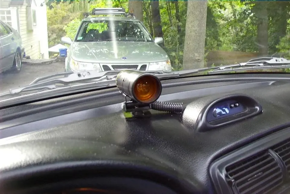

next to my clock, and back a little. i guess i might have to run the wires into the air vents.
EDIT: it will be close to the clock, so maybe i can run them under it where the clock wires go into the dash. how can i remove the clock?

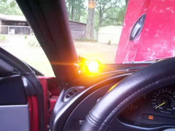

The clock just pops out from the top of the dash. FWIW, I mounted mine right behind the steering wheel and ran the wires behind it right into the dash.
The shift light (it's a raptor performance)
Another angle, with the caps (red for night driving, black for no light). Ignore the bandaged hand, I stabbed a saw through it that week, lol.
Top view, the wiring runs down into the steering column.
An overall view, nice clean look there with no wiring.

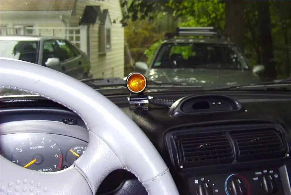

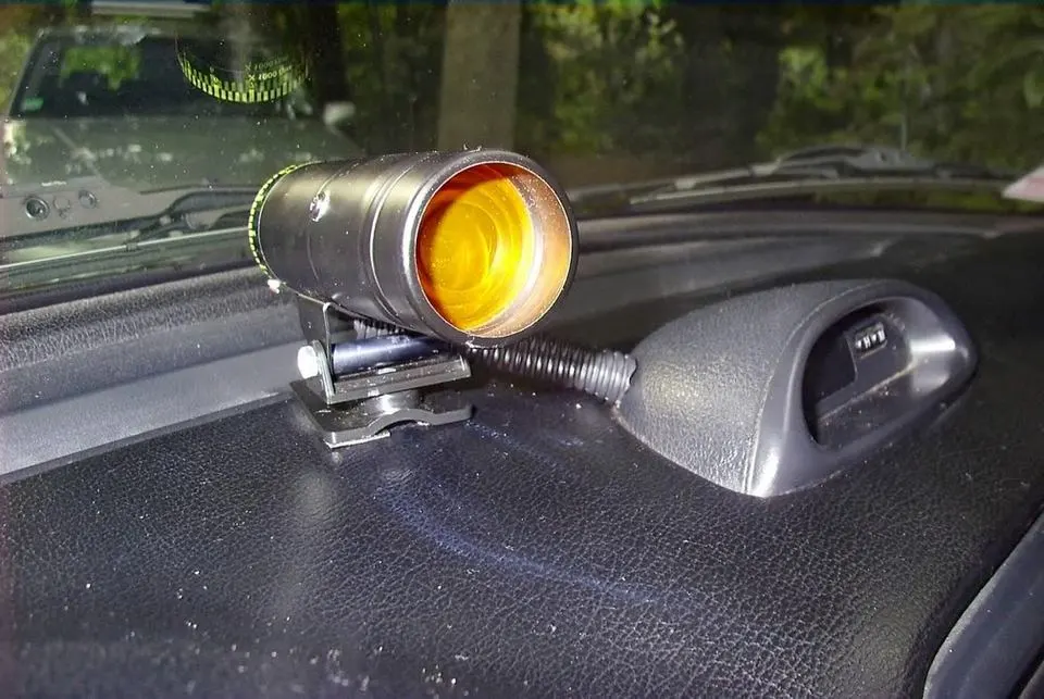

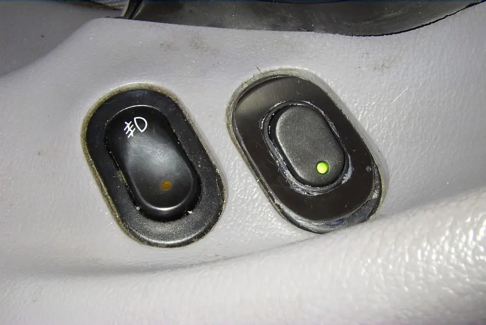

me too, just finished the install. i ran the power wire to the cig lighter, same with the ground. and i installed a switch to turn power on and off which replaced the coin holder. everything looks real clean.

switch is kind of a hack job until i have more time to clean it up.

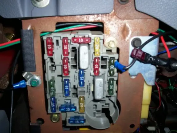

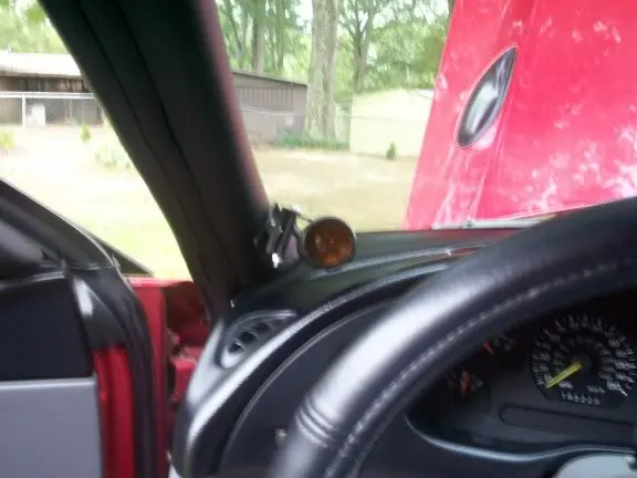

red wire off shift light goes to fuse box to a fuse that has 12 volts with key on only (see pic.). black wire goes to a good ground. and the green wire will splice into the tan/yellow wire coming off the coil....
The Green GT
No 13 year olds are safe around me.
Jan 8, 2006
1,269
99
Louisiana
Feb 22, 2007
#19
  • Feb 22, 2007
  • #19
I have my light in the same spot as bill302.
And I wired it the same. But you dont have to run the green wire to the coil. Just find the tan wire with the yellow striper behind the cluster and run all your wires back there.
