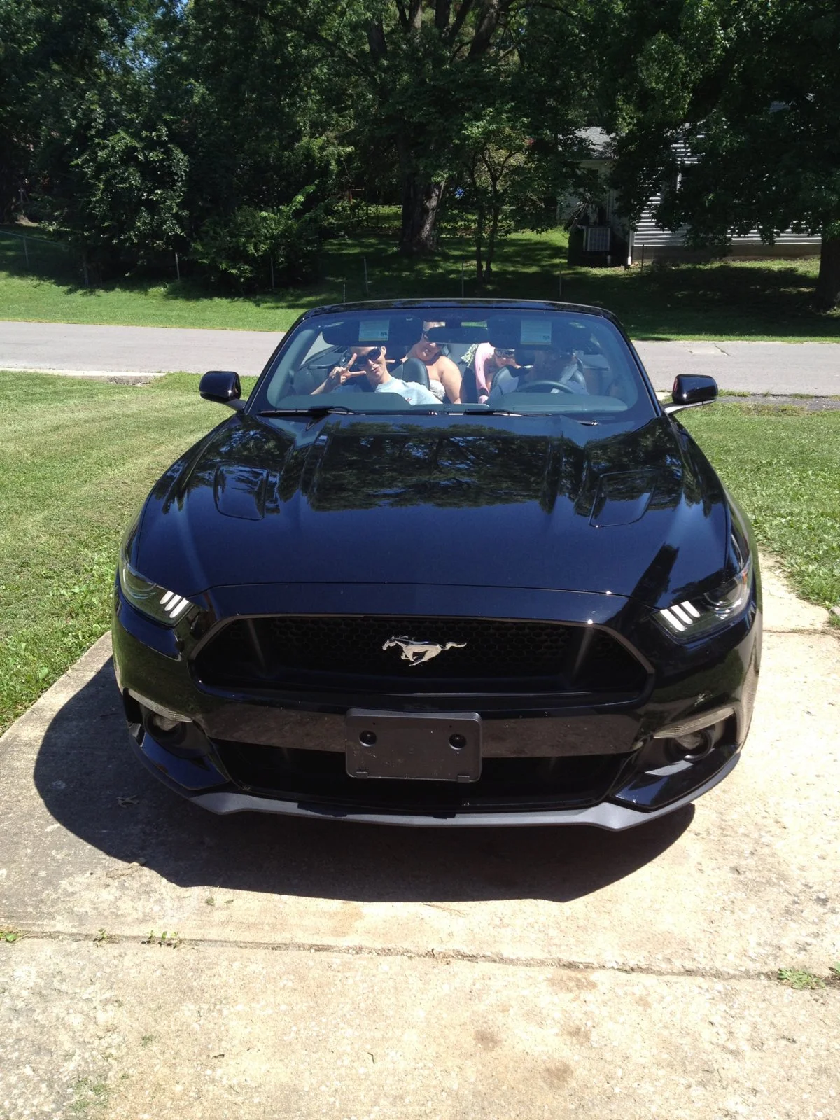

Thank you for showing me how to post pictures.
I just realized I don't have any photos of the old 83, but I found one of Barb's 2015 just to see if your instructions would work for me.
