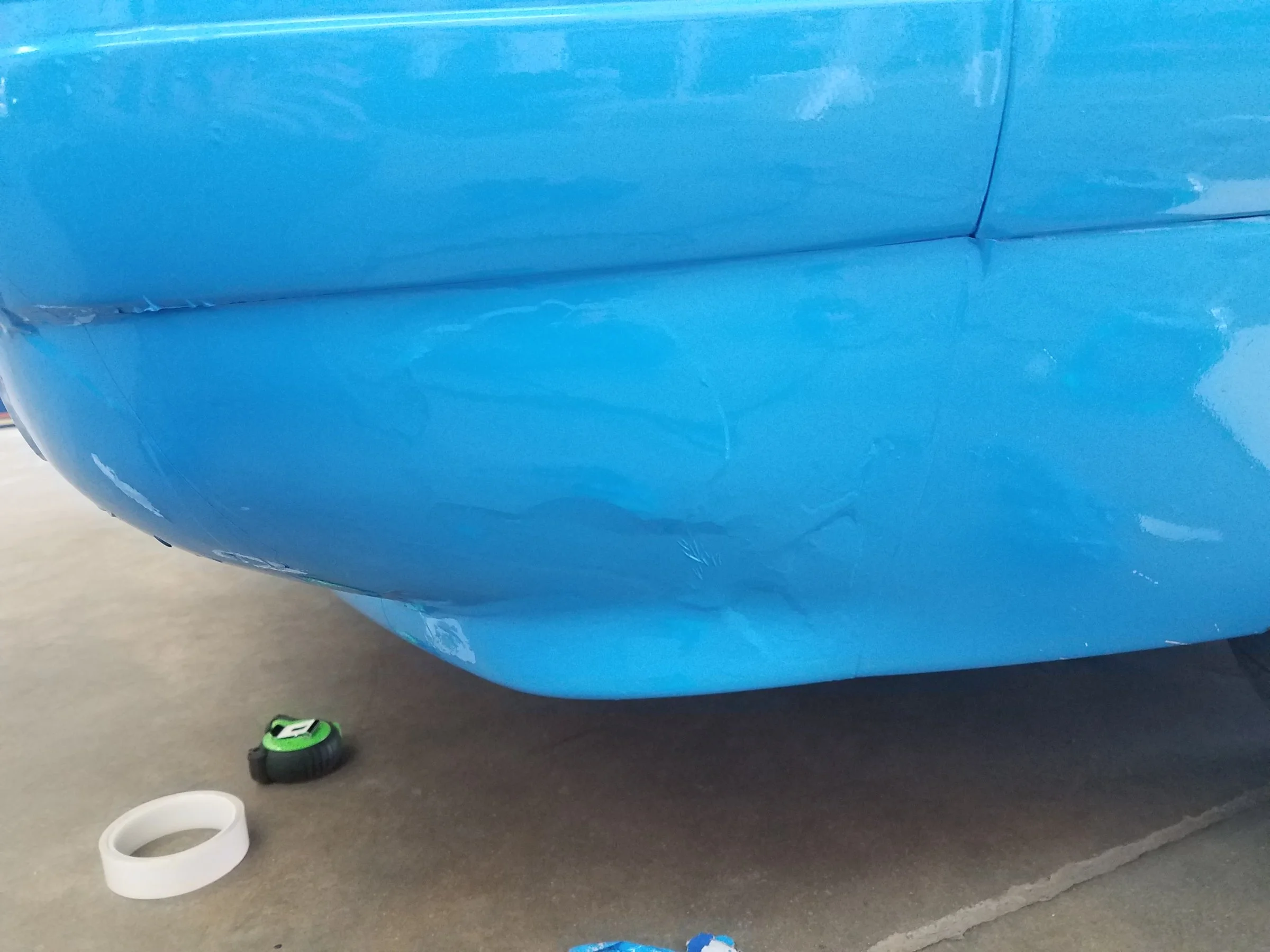

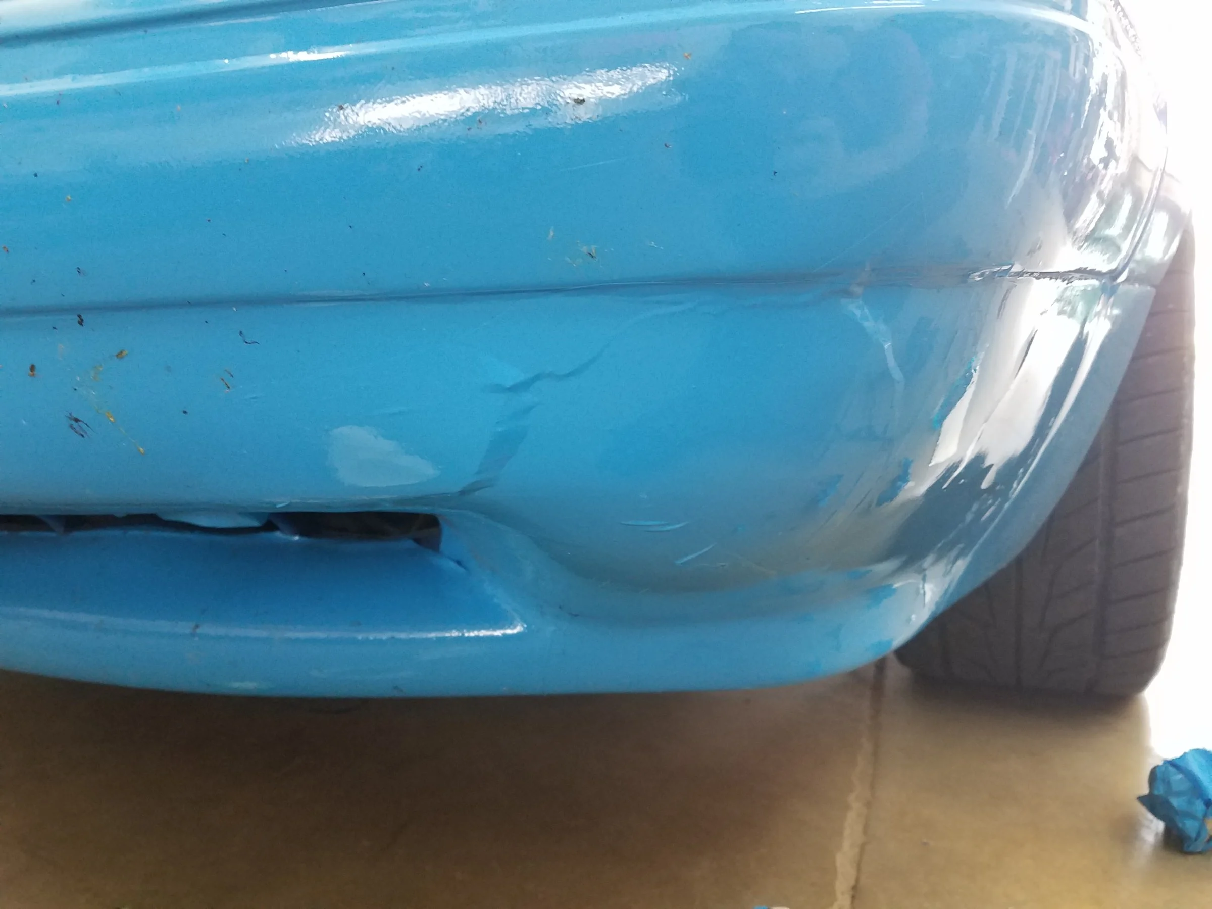

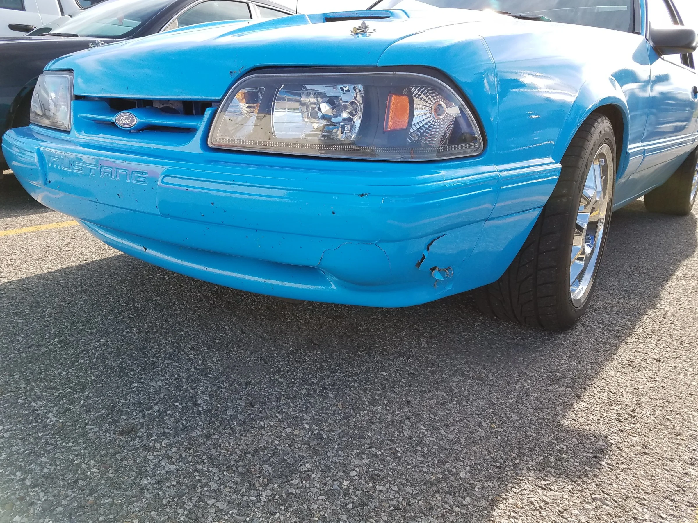

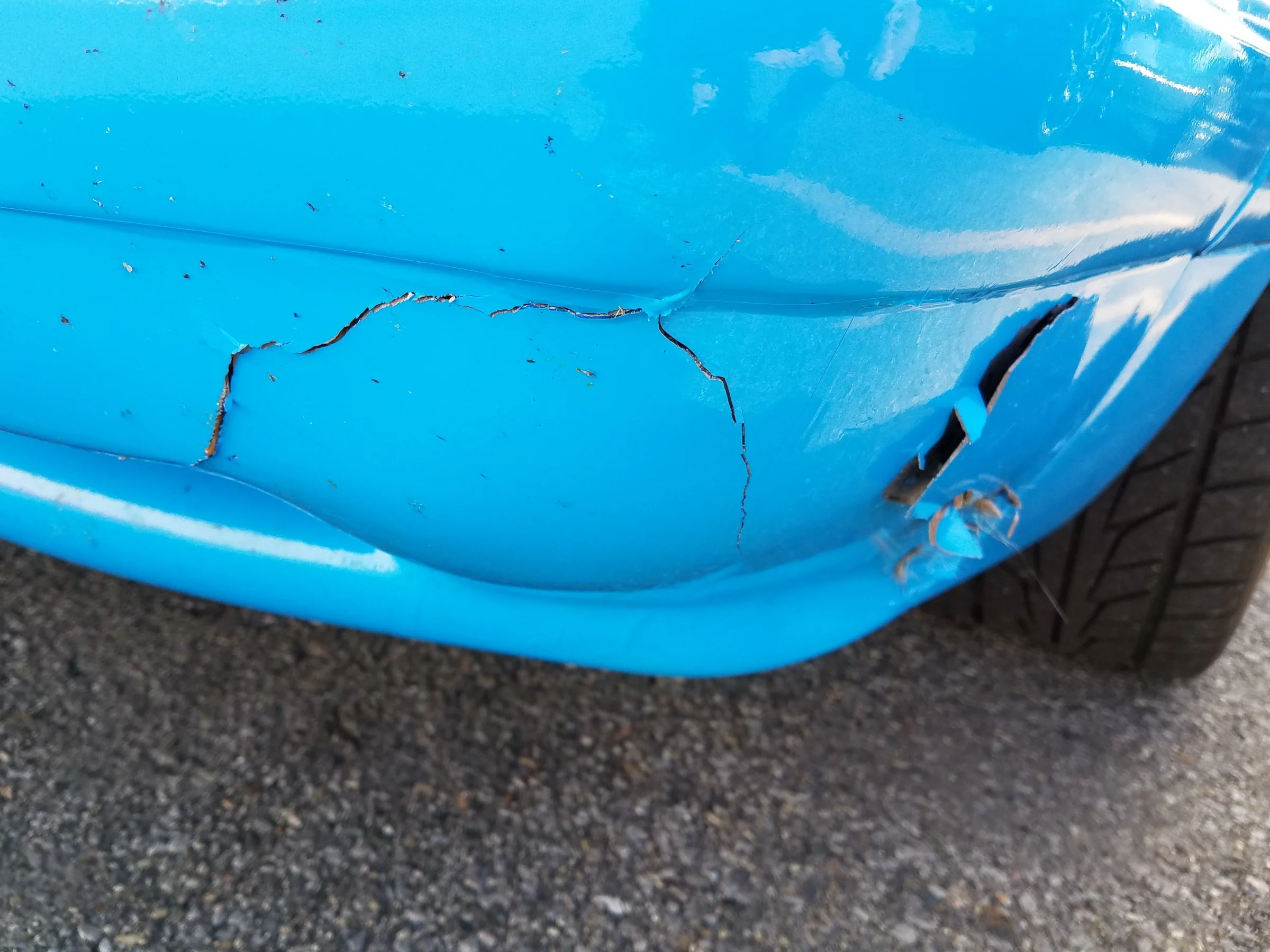

On my way to work monday moring at 4am, I came across a racoon that had decided he had had enough of this world.
Of course, he picked the side that had been previously damaged and repaired.
I did a quick "bandaid" job on it to make it more presentable until I can find a replacement bumper cover for a reasonable price, less than 5 hrs away.
It looks better, but still pretty shtty...

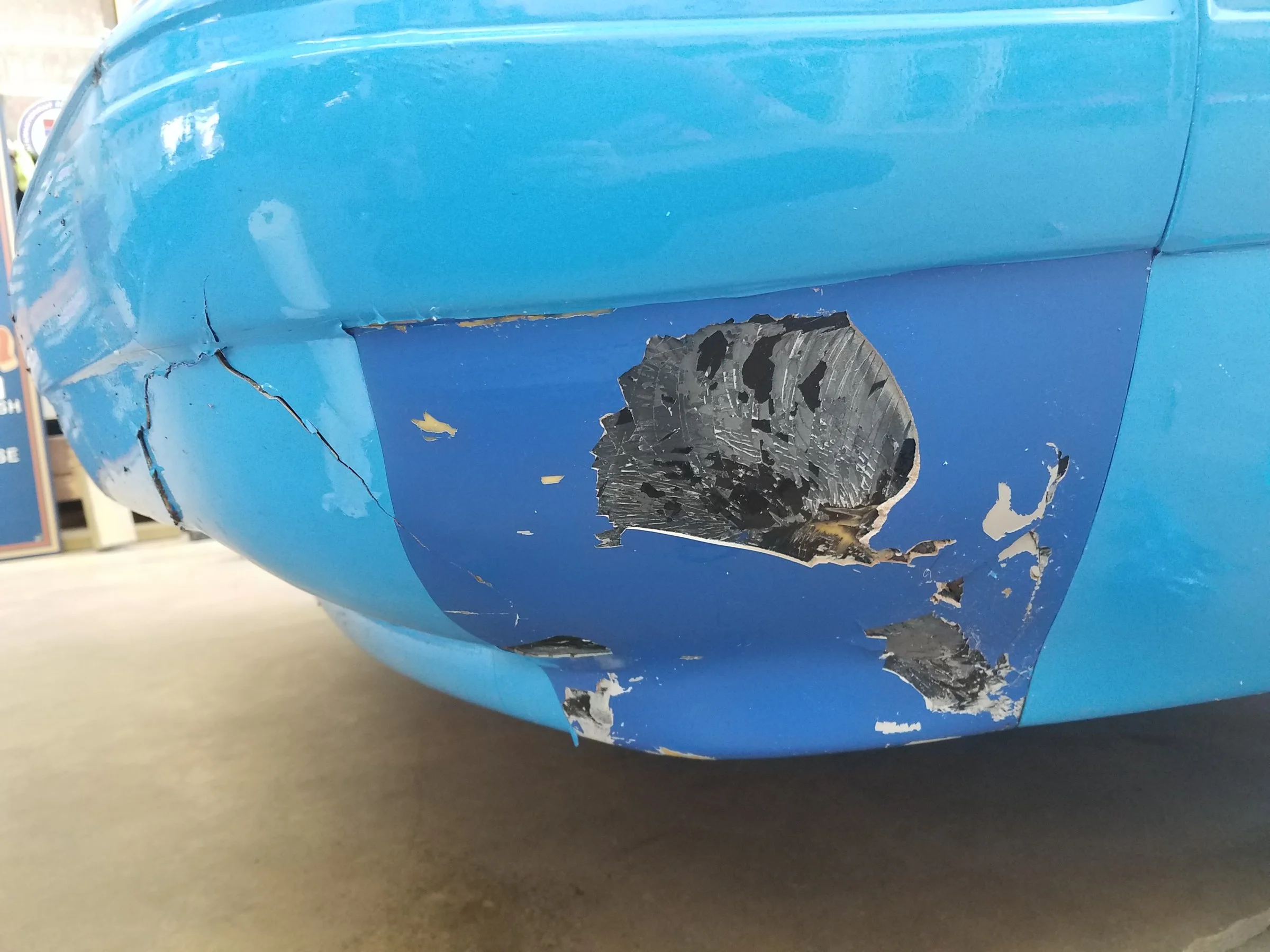

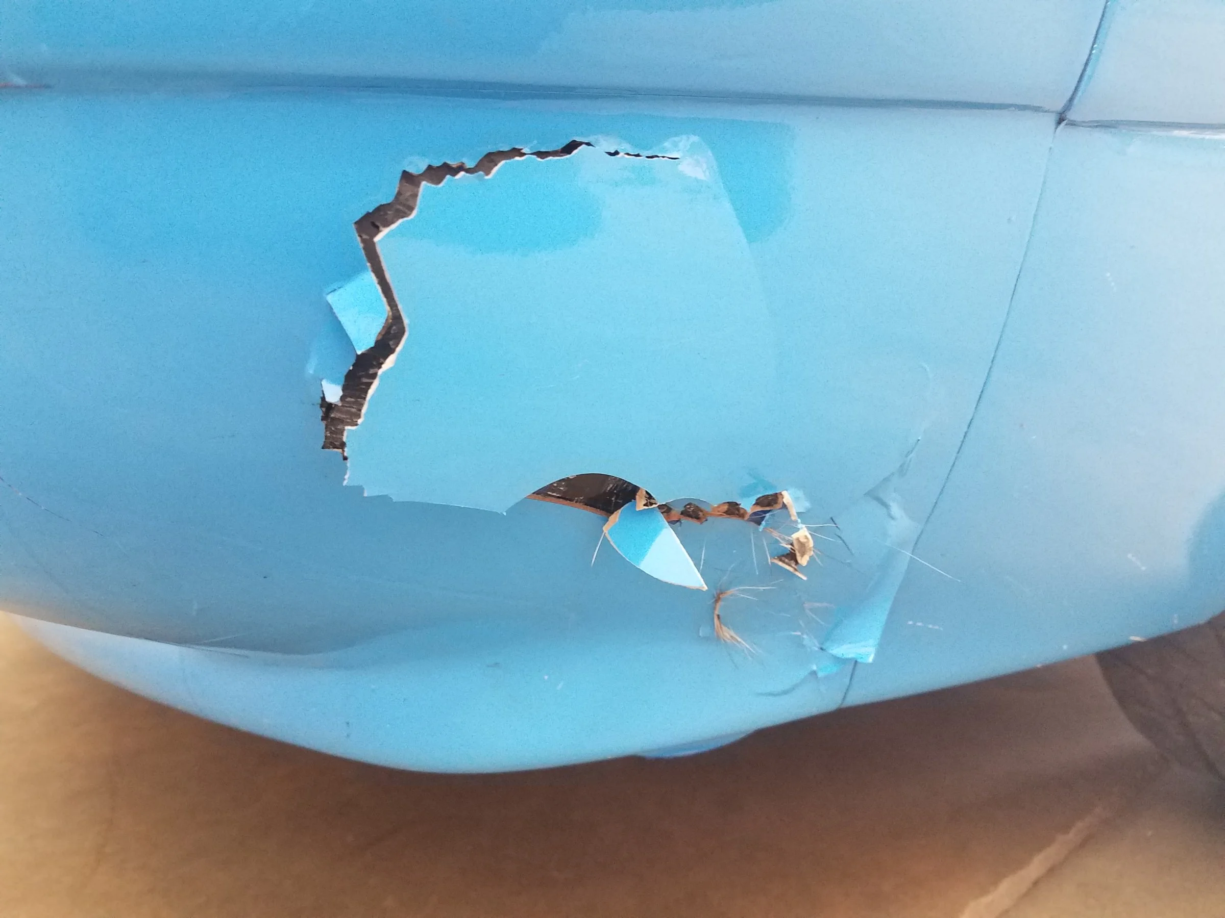

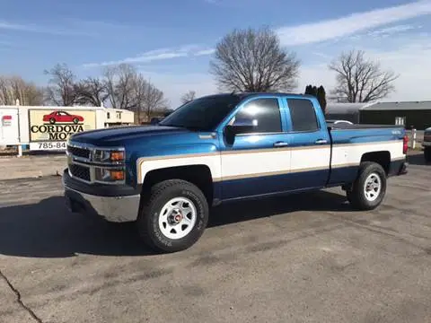

In front of the car is $700 worth of blue and black vinyl which I'm pretty sure will be enough to wrap my truck (that is white now). Goal is to have the truck have a similar theme to the Mustang. I can post some stuff on that once I get going on it if you guys are interested.

It isn't super hard, just very time consuming. I want to say I had about $400 in vinyl to do the fox. I am cheap though, and put in extra seams so I would use less material. That car was a 10'er at best on a good day anyway... I've got about $700 in vinyl for my 4 door short bed silverado with a cap.
