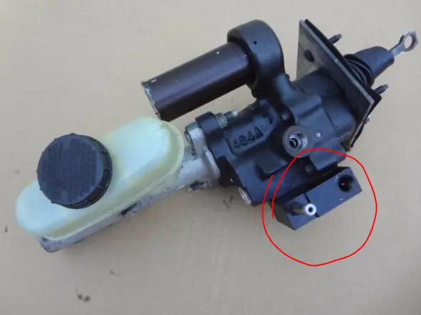

Looking for the block that bolts to the side of a 99-04 Mustang hyrdroboost.
This block has a low-pressure port threaded into the front. (silver fitting in photo) Most are right-hand thread, some are left-hand thread. Looking for a block with the right-hand threads on it. I currently have a Left-hand threaded block and can't find a 6AN adapter for it.

No sorry, i ended up using the block I had with the left hand threading and just wending a 6AN bung to the low pressure fitting. I was able to use it for my needs after that.

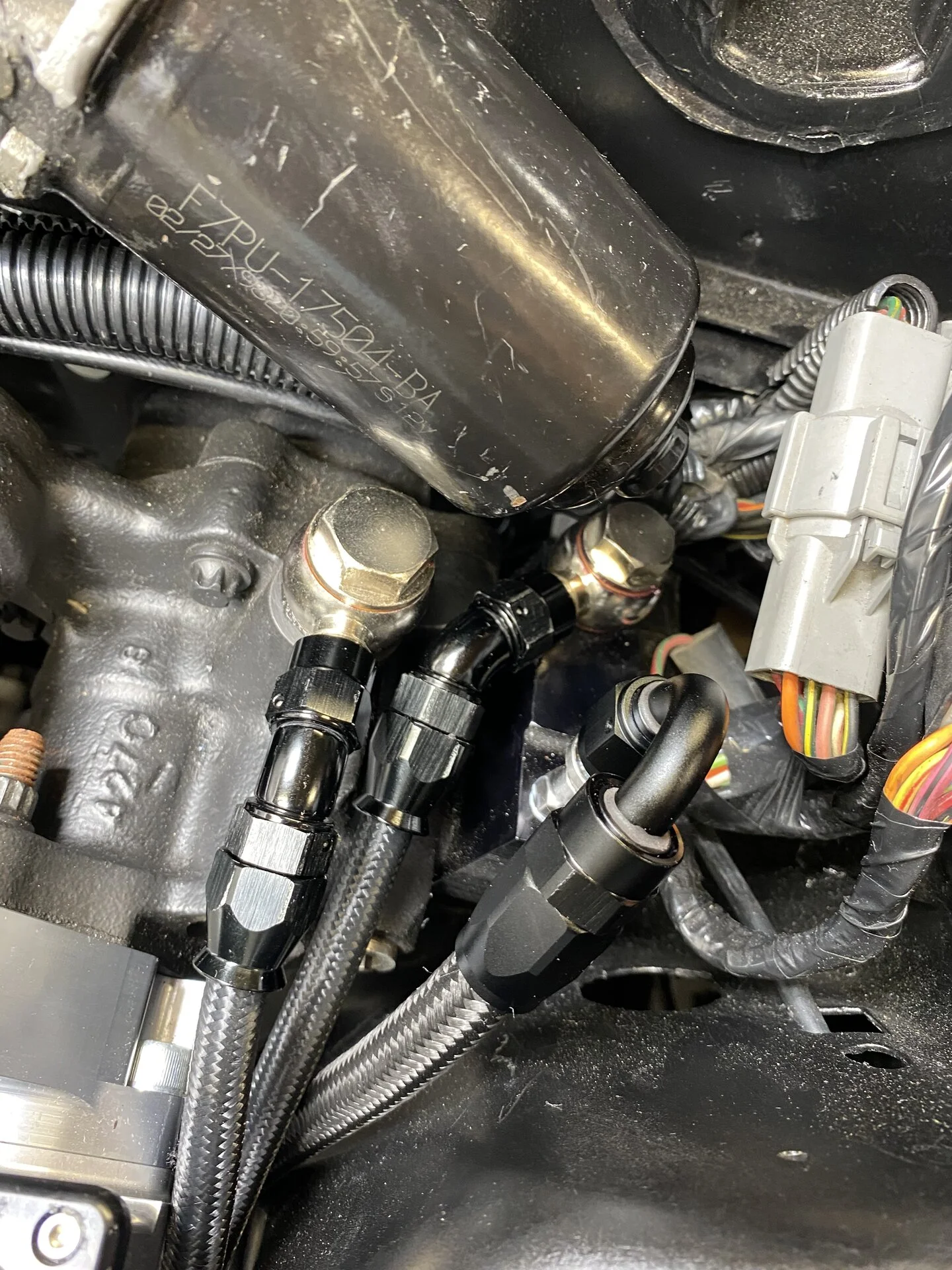

Anyone have the part numbers for the banjo fittings in the picture ???

I don’t have the part numbers. They are m18x1.5 and m16x1.5 banjos I snagged off eBay or amazon. They sell versions with o-rings which I don’t recommed. These are the versions with a copper crush washer on each side. No leaks.
The low pressure return is custom. I took the stock barb fitting and welded a 6AN bung on the end.
