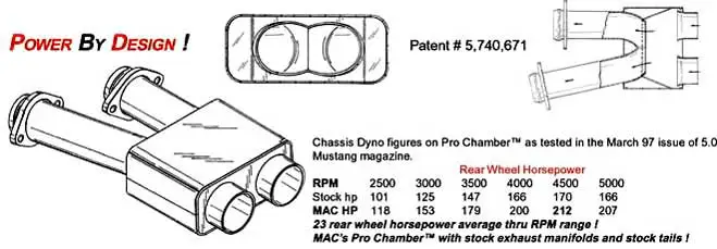

I'm just messin with you guys. You're right though. I hate the sound of my X-pipe. Raspy and high pitched. I think the Mac guys were on the right track with the Pro-chamber but dropped the ball when they made the back squared off with 2 pipes attached. Now if they'd split it at the back and make two transitions from square to round tapering down kind of like funnels they might have something that would flow a bit better. Looking at the design it's pretty easy to see that as soon as the exhaust enters the Prochamber the gasses will expand and to get out the other side it would be like throwing a 5 gallon bucket of water at a 21/2" hole in the wall. Kinda hard to explain hopefully you know what I mean.

EMW150 said:
. I think the Mac guys were on the right track with the Pro-chamber but dropped the ball when they made the back squared off with 2 pipes attached. Now if they'd split it at the back and make two transitions from square to round tapering down kind of like funnels they might have something that would flow a bit better. .
You mean like this ? :D
