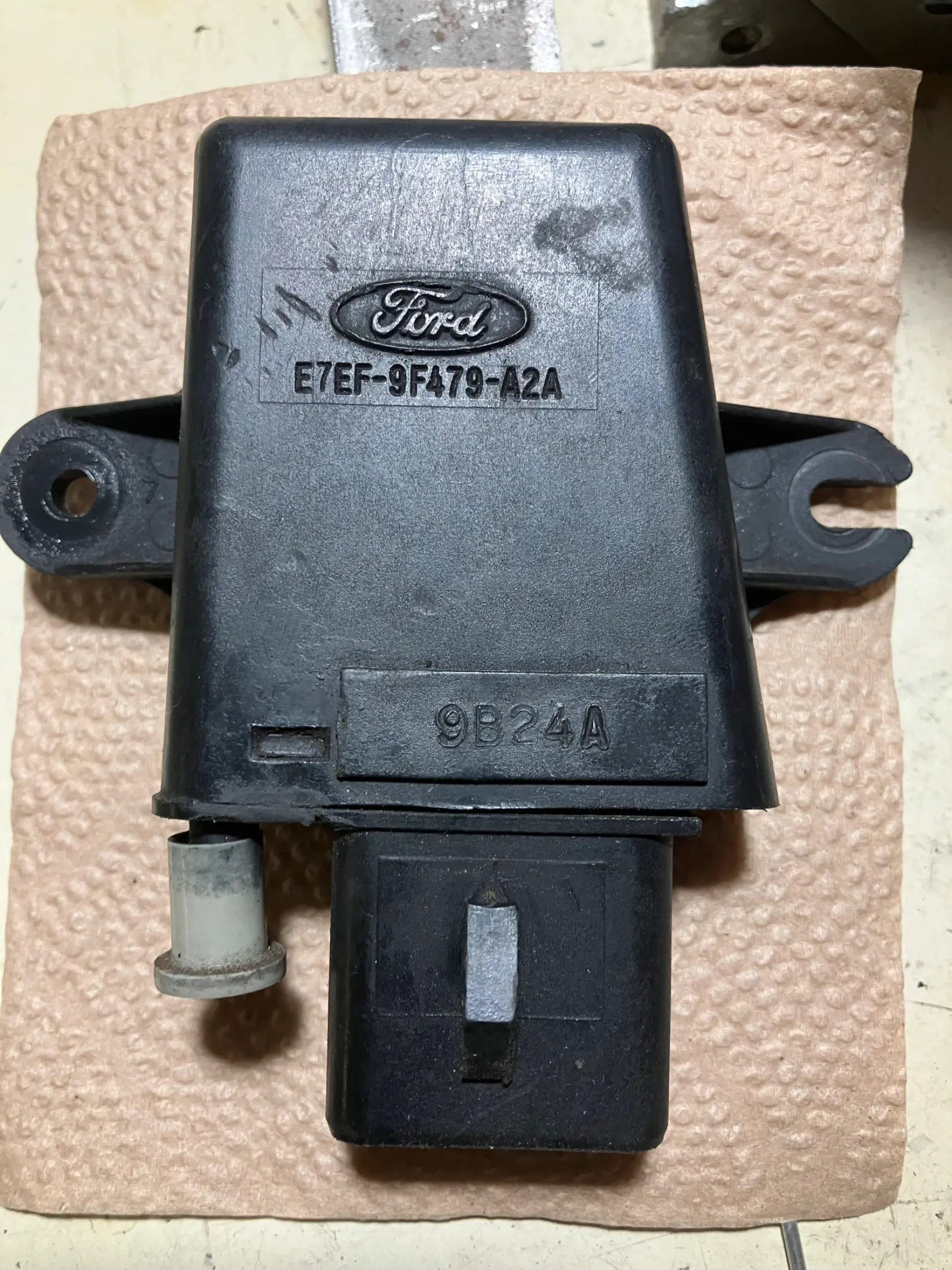

SORRY, I HAVE TO ASK THIS QUESTION:
There is a sensor not too many people talk about and who knows maybe this is my problem!
I’ve read that a failing BAP sensor not always triggers the check engine and don’t always produce an error code in the ECU. One of the symptoms of a failing BAP sensor is a high fuel consumption.
Dos anyone in here had that sensor failing? And how do you test it without a frequency tester?
This BAP sensor communicates with the MAF sensor to do the appropriate air speed and density to adjust fuel/Air mixture. I hope this is the root of my issues but must have some expertise from all of you plus how to test it.
Thank you all so much!!!

In your case, it only registers ambient air pressure during startup.
Reactions: PonyGTrider
So are saying that if I unplug that thing will only affect me during startup and the MAF and computer will disregard the signal from this barometric pressure sensor? Now I’m more confused…

  • #26
It references air pressure at startup so it knows which cold fuel table to go to.
Once you're warmed up and in closed loop, the HEGO and other sensors make that determination.
Ok I got you,
Now one question just arises
Is that BAP sensor a specific part number per vehicle year?
My question is because I removed the BAP sensor from my 90 GT and the Part Number is E7EF-9F479-A2A
But when I did a google search AI suggested part number:
  • Ford OEM Number: E7FZ-12A644-A
  • Engineering Number: E7EF-12A644-A1A or
    A2A
  • LMR Part Number: LRS-12644A
Is there any difference if I use either one or this could be the root of the extremely high fuel consumption?
Thank you much for the help!
