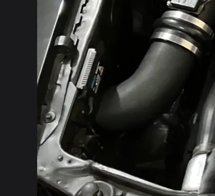

This wouldn't happen to be a MAF adjuster, would it?

Hehehe no it is a headlight ballast

Whew. LoL
