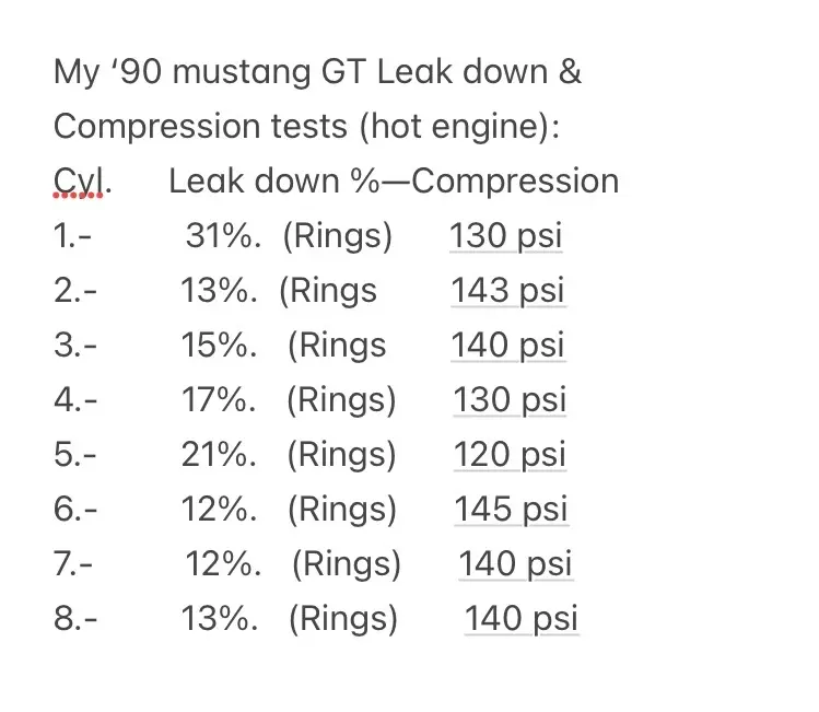

And here they are. Leak Down where did they leaked thru and compression tests:
Will this give a better idea if this is causing that awful fuel economy of 9.5 miles to the gallon????? Please comment on this and if this is the cause how would troubleshoot to fix it???

What is bothering me is that the compression tests are not jiving with the leak down test if the test equipment is known to be accurate and the tests were performed correctly. I know you had the motor at operating temp but I do not know how you did the testing. Biggest thing there is you have to make sure that both valves are close during the leak down test.
So here I would expect either Cylinder 1 to have less compression than Cylinder 4 or Cylinder 4 to have more compression than Cylinder 1
Cylinder 1 - 31% with 130 psi
Cylinder 4 - 17% with 130 psi
And here I would expect either Cylinder 1 to have less compression than Cylinder 5 or Cylinder 5 to have more compression than Cylinder 1
Cylinder 5 - 21% with 120 psi
Those two examples are completely opposite of each other so needless to say it bothers me. Maybe I am reading into this completely wrong but its not what I have typically seen. Typically the less the leak down % is the higher the compression is.

Yeah I was intrigued by the non sense between the leak down/compression tests but it is what I got putting every piston at TDC. The problem could be the cheap leak down tester I ordered, the percentage gauge needle was sticking up and was hard to calibrate so I had to take it apart and lubricate some brass gears and pins and ran a bit smoother but still I had to calibrate the meter almost for each cylinder may I created inconsistent reading because of that. On the other hand all the measured leak percentage was bleeding thru the rings not thru the valves so I know the valves were closed.
