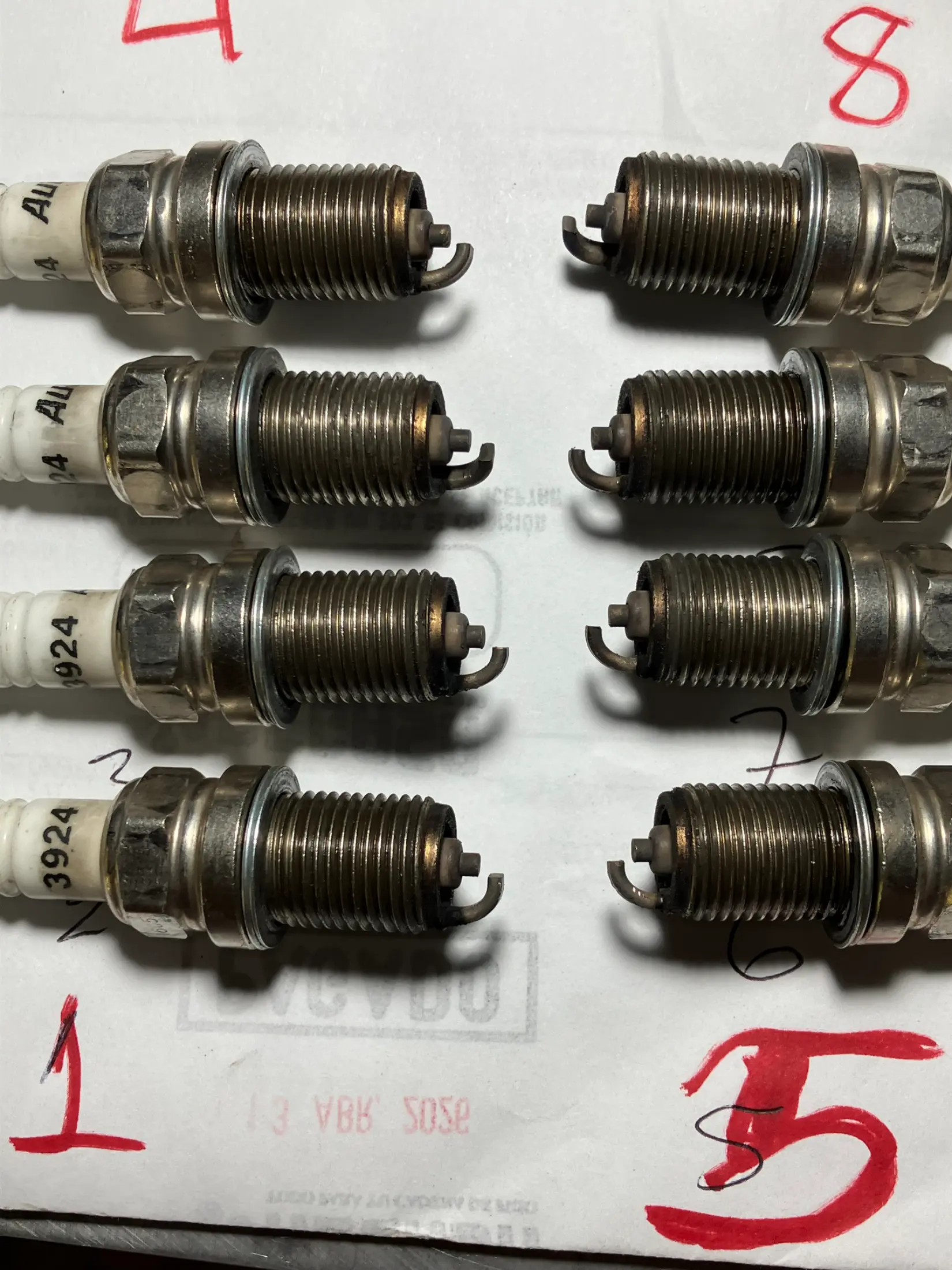

I just removed the sparkplugs and they don’t look like overly fueled, but who knows… They are side gapped at 0.040” and they run awesome! I tried from 0.054” down to 0.40” and there is were it runs the best.

They look slightly darker than I'd prefer, but not 9mpg dark.

PonyGTrider said:
I’ll see about that possibility
In regards to compression I will re do the test and one thing for sure there is no Blow-By, I have an oil watch can and there only appear three or four drops of oil once in a while.
Thank you
Why is the strap cut back on all of those spark plugs?
Reactions: PonyGTrider
It is what they call “Side Gap” and the intention is to expose the spark without being hidden under the strap. That is something I followed up to improve the combustion but tuning the plugs with normal ground strap makes no difference on the poor fuel economy, but it kind of make sense to use side gapped plugs so I did that.
Put a new set of properly gapped, unmodified copper plugs in there and re-evaluate.
One of the things that doesn't need help on a fuel injected Fox is the ignition system. It provides hot and fat spark, all by itself when it's in good condition.
If you really want to play with the plugs, index them.
Reactions: FastDriver, DadLife0724, PonyGTrider and 1 other person

I know I’m running more compression than you are and I’m gapped at 0.050 and my plugs look waaaay better than that. Those look rich if you ask me. This picture is super basic but Inthink you get the idea.
Yep I will do that but first I will run a leak Down test tomorrow as soon as I get the tester I ordered. I’m very suspicious some things are pointing to that or timing.
I want to find what is causing this terrible MPG once and for for all, but yes I will follow your suggestion
Actually I tried indexing the plugs but I’ve must done something wrong because my engine ran like crap!!!! I might try that again.
Thank you
