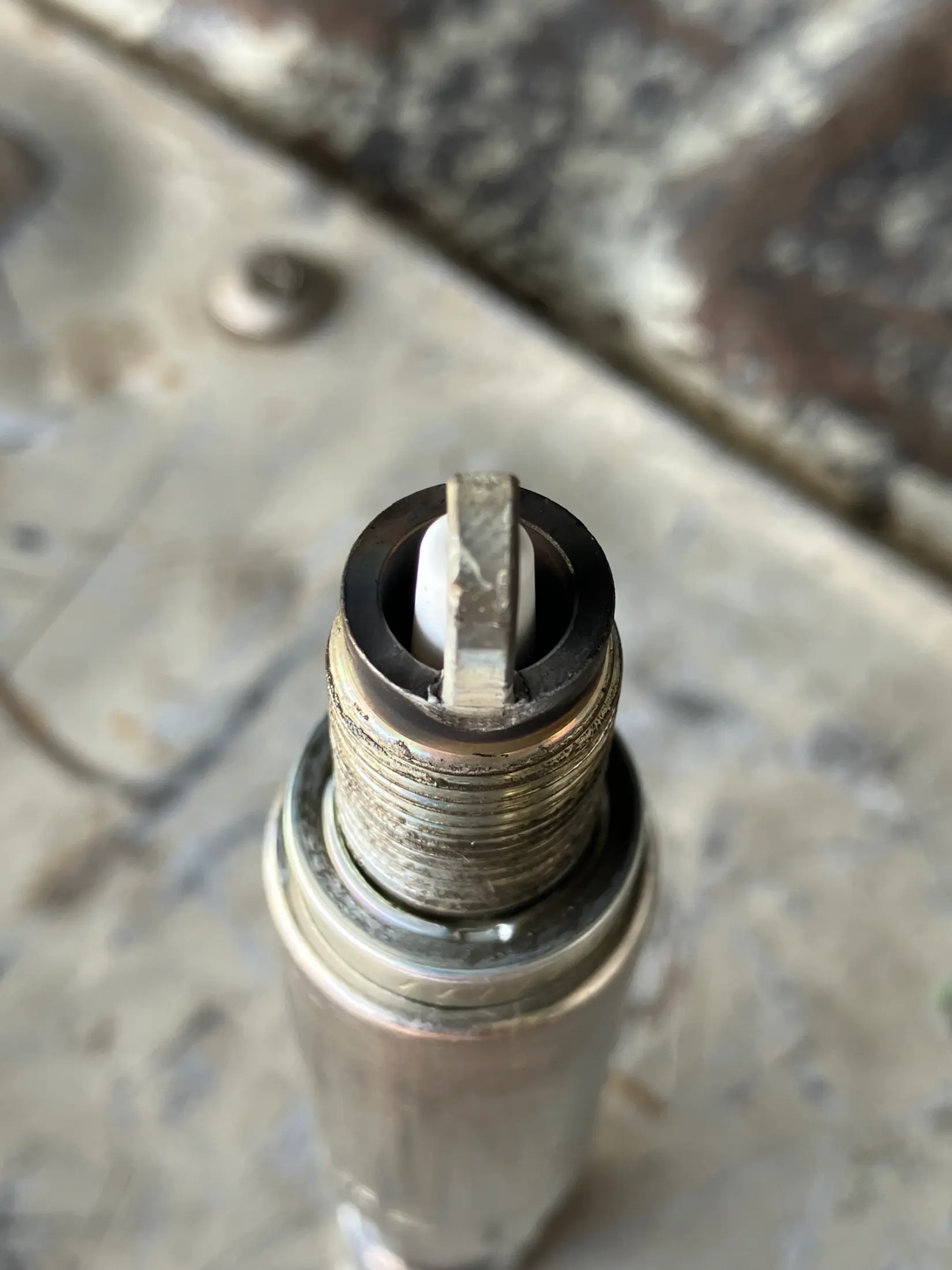

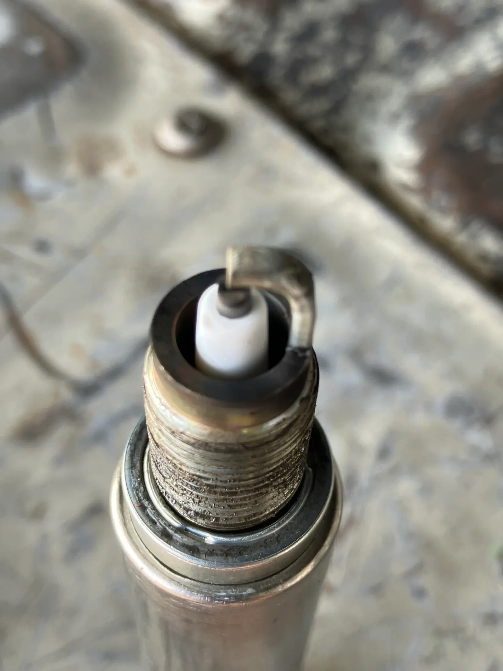

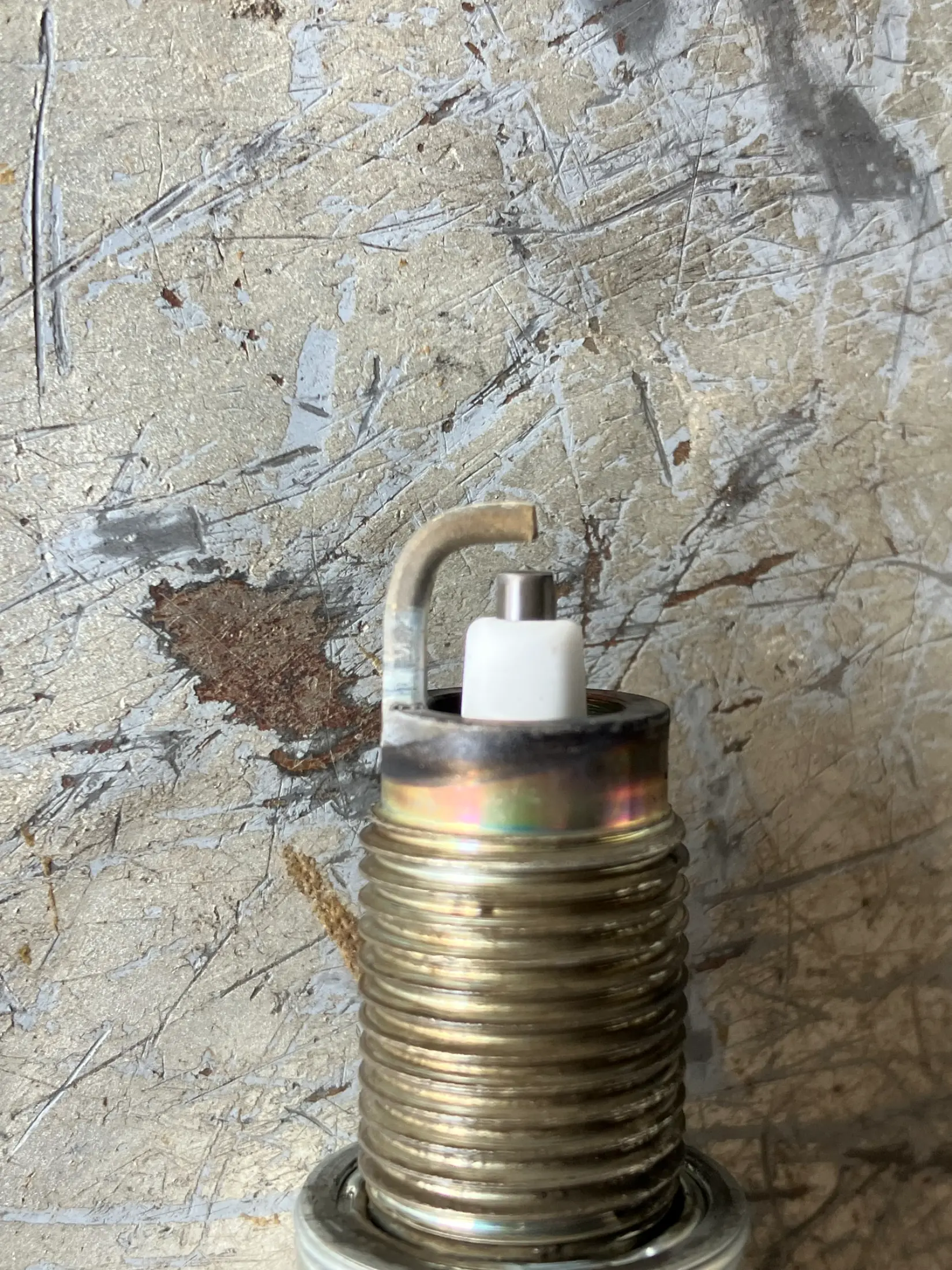

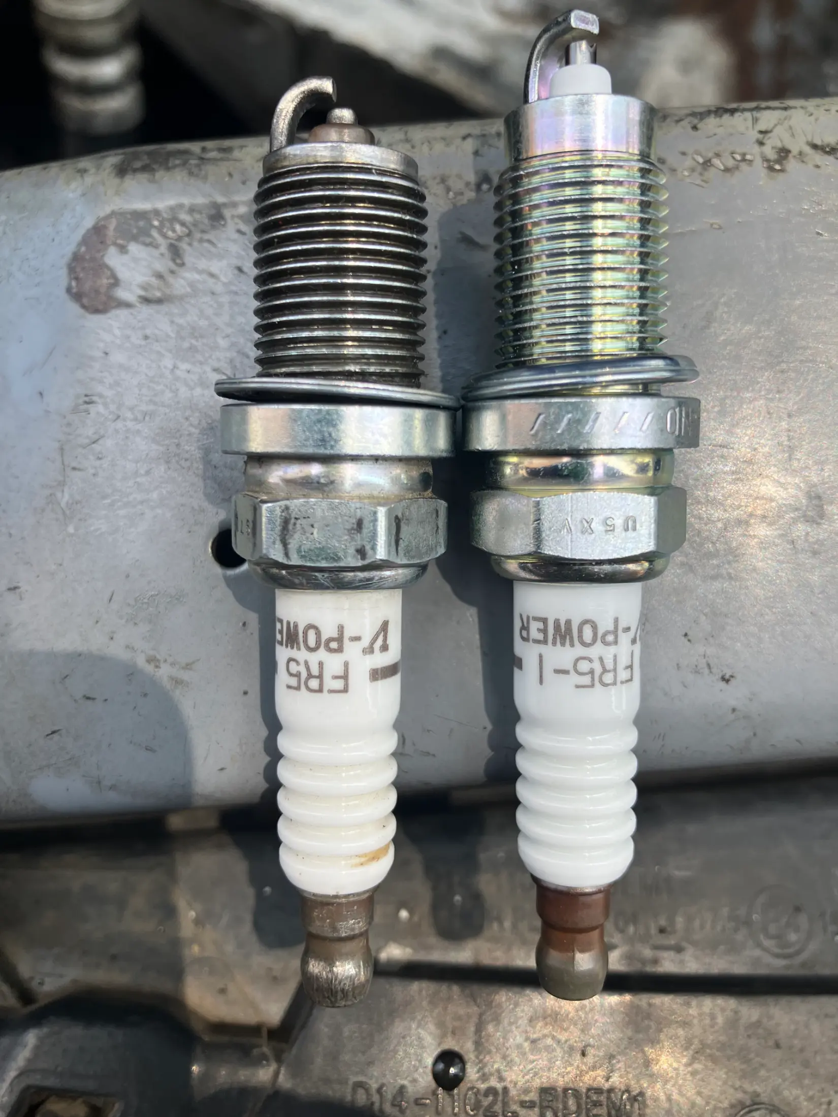

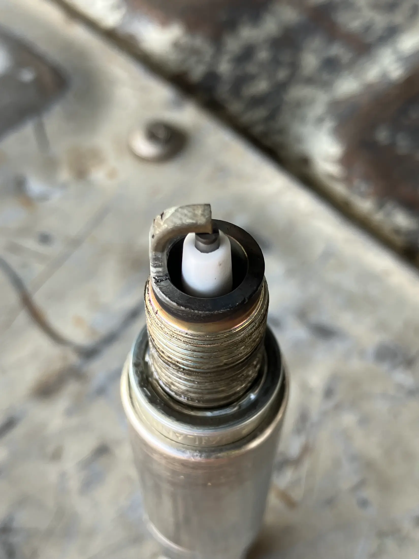

A quick UPDATE:
After searching for either a set of Autolite 3924 and NGK FR5 spark plugs which I found none I got a set of NGK FR5-1 which is longer than the NGK FR5 and before I threaded them in I measure the clearance against the piston and had about 0.200” gap. I then calibrated them to 0.054” then I took for a ride a few mile with some wide open throttle then return home and here is just a sample othe plugs out of cyl 1
I’ll wait for the engine to cooldown before I take the rest out.
So tell me now what do you think about the No 1 cyl coloration on these multi angle photos. Also there is a picture of the FR5 left and the FR5-1
Normal? Rich? Lean?

Aftermarket heads like the TFS’s require different plugs. Were you running stock style plugs?? They will be too short and not get into the combustion chamber far enough.
Reactions: PonyGTrider
I was using what everyone else the ones recommended by trick flow NGK FR5 but couldn’t find any so I’m using one a bit longer which is the NGK FR5-1 I posted a photo a few lines up

I would just wait until I could get a wide band on the car and see how things look. I would put two bungs on the exhaust (one passenger and one driver) so you can see what each bank is doing. Will require swapping the sensor from side to side but all the work you have done to date swapping them would be nothing.

Run those new set of plugs for a tank of gas and do your usual calculation to see where you're at.
You'll get a better read on the plugs too.
Wow... The length comparison in your image makes them look really long.
