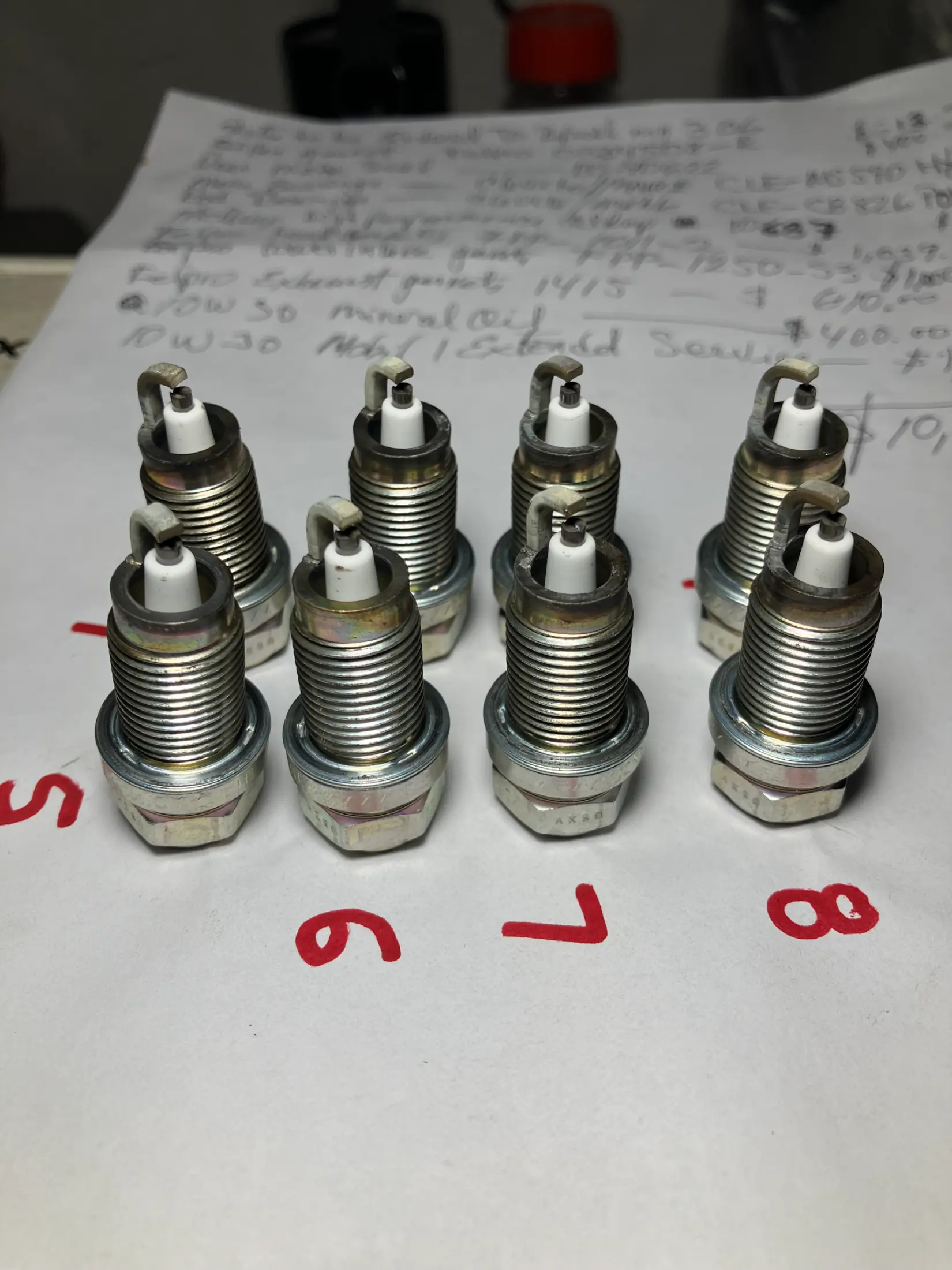

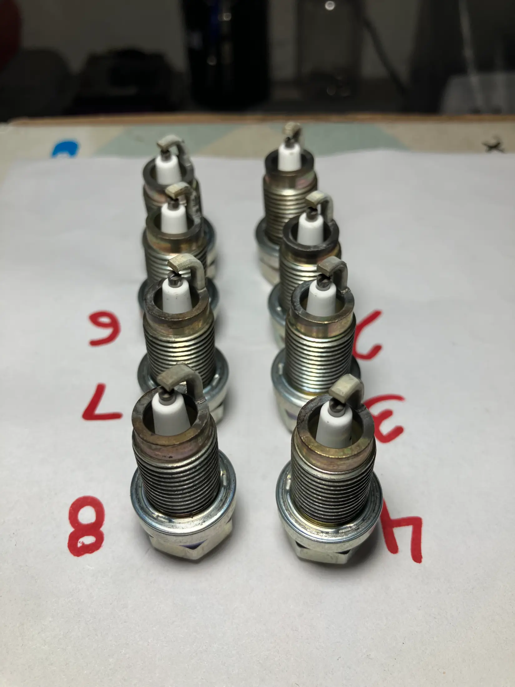

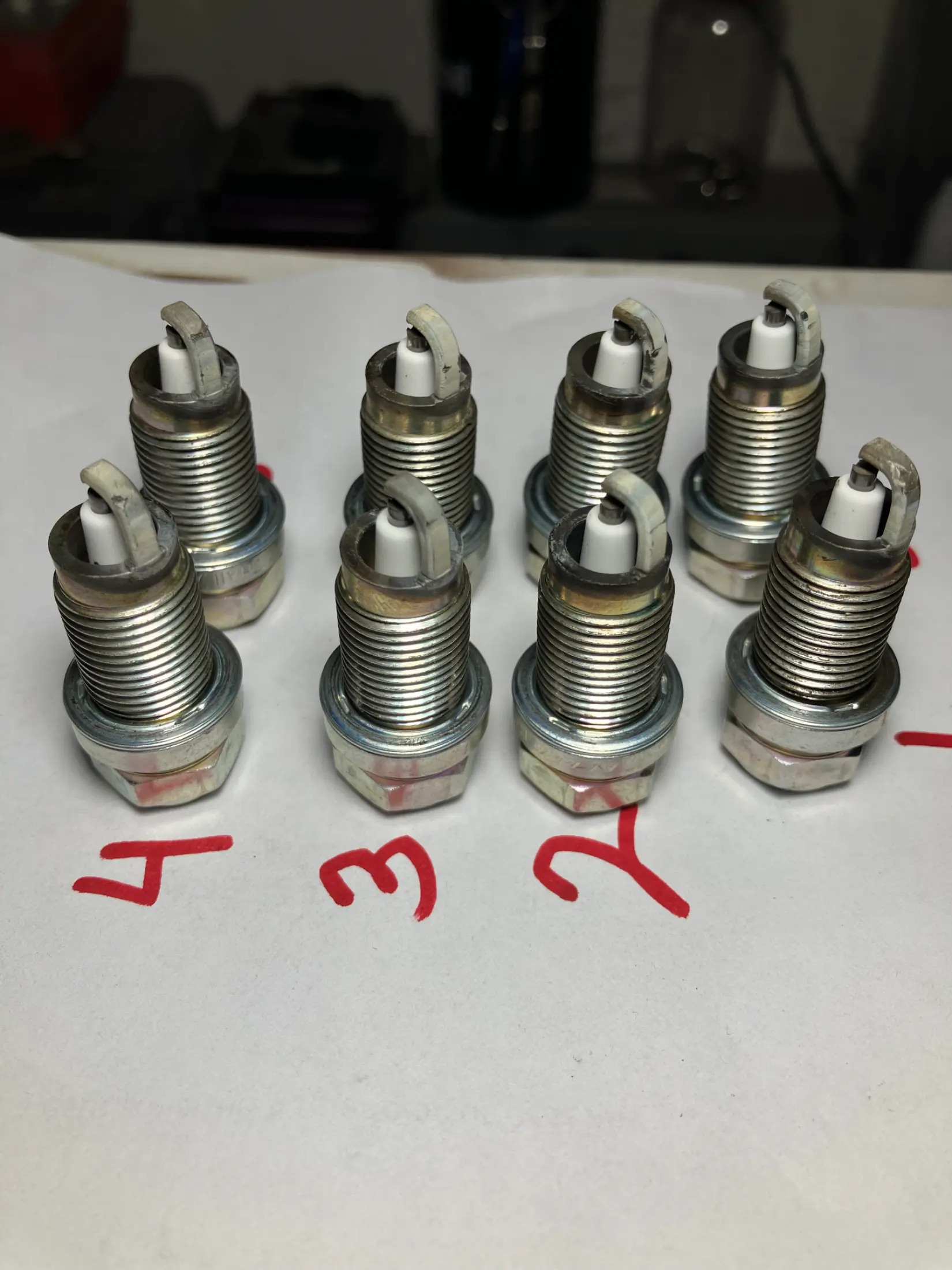

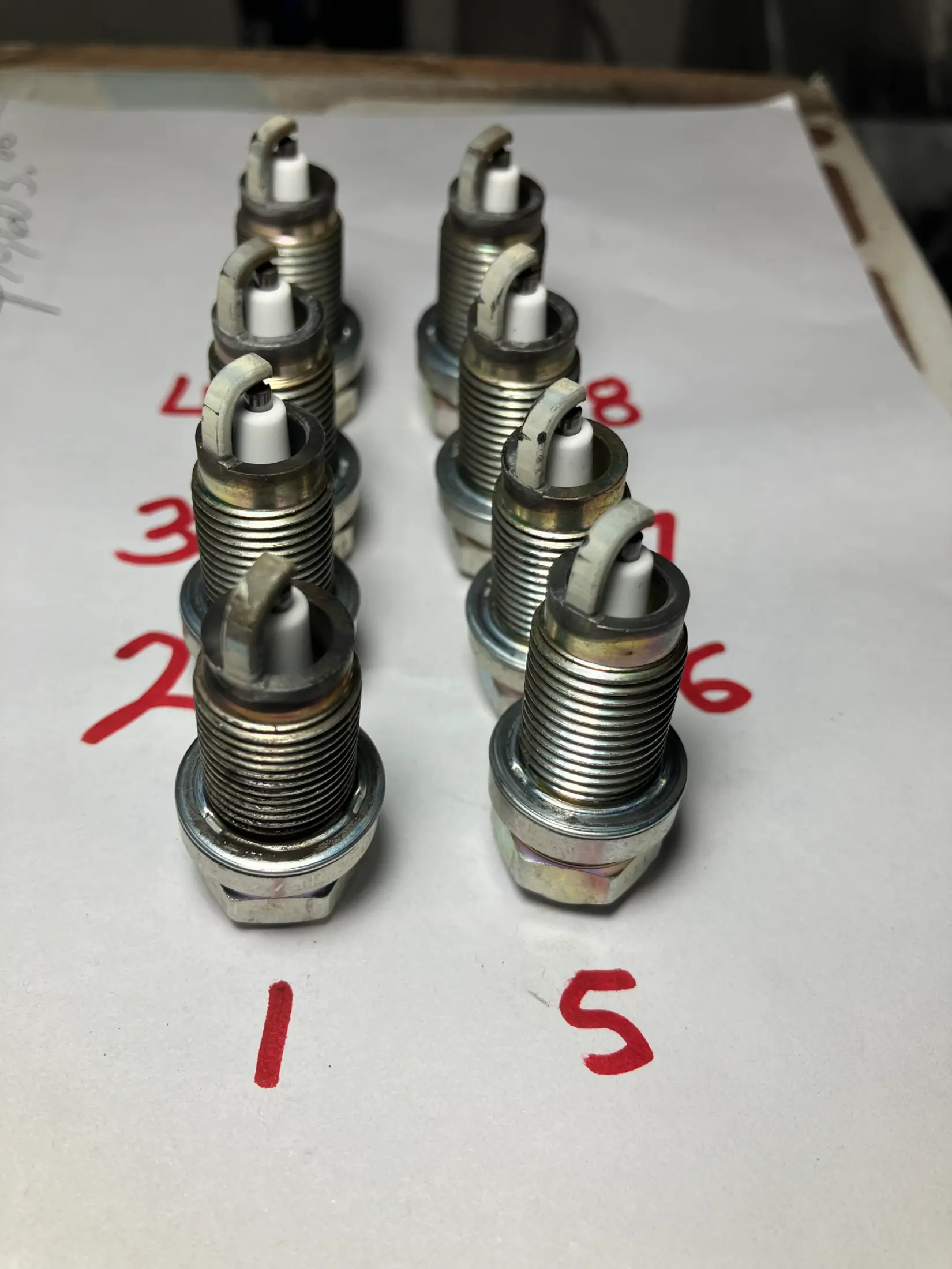

HERE IS AN UPDATE:
Ok guys here brand new NGK FR5-1 sparkplugs calibrated to 0.054” with about 8 miles with few springs at WOT with 84 octane gasoline 19lb injectors, 210lph fuel pump, fuel pressure at 39psi with vacuum hose connected, and 14 degrees BTDC of advance.
Let me know what do guys notice as far as air/fuel mixture? NORMAL, RICH, or LEAN condition? Any indication of over fueling as to cause a pathetic 9.5 miles per gallon???
Please I’ll read all your comments
