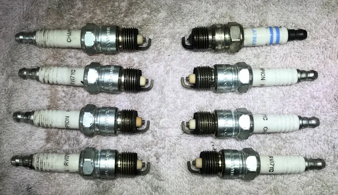

Let me explain what I'm seeing and maybe others will see it too:
This is an image from another thread on this forum. In this case, the member was getting oil in the intake. I'm not certain what he was trying to discover by putting a single platinum plug in the engine but... It helps to illustrate a point:
You can see the soot from the oil the ring and threads on all the plugs but only the platinum plug failed. It just wasn't getting the combustion mixture ignited like the copper plugs were with their big ole' fat electrodes and already [hot] OEM ignition coil. That small, condensed spark just wasn't getting it done.
The modification to these plugs attempts to accomplish a similar thing:
It condenses the spark to smaller surface area to increase the intensity of the spark. You can even see the aprk is concentrating on these electrodes.
Windsor engines to not respond well to this. You can do a search of the Fox section or Google or Youtube about how Platinum, Iridium, etc... spark plugs act in our engines.
So, let's assume for a moment that combustion is not being fully ignited or is starting so small that the exhaust valve is opening before combustion is complete. 16 degrees of initial timing supports this idea too. This is the head-start these plugs need to be fat enough to run well.
Then there is the enrichment issue:
An engine is an air-pump. It is a car guy cliché.
O2 sensors do not read raw fuel. They do not sense combustion fumes or fuel density. They detect free oxygen. So, the EEC sees all of this free oxygen in this unburned exhaust gas and does what? Enrichens to fuel to compensate for all of the free air it's finding. And narrowband sensors? It is [low] [off] [high]. It is essentially just a switch.
This is why I keep beating the podium on these plugs. You need to give it all a chance to have a reaction.
Let them new plugs chew for a bit. Give the EEC time figure out the new surroundings. The O2 sensors may have taken a beating sitting in that exhaust for a while but let's see what they say.
"She only needs what she needs, fellers." ~Derick Biere (I dunno how to spell it. The Vice Grip Garage guy)

Thank you for this whole explanation. I modified those spark plugs like three weeks ago following a claim that you have better combustion with side gap plugs, and I did this as another way trying to better my pathetic fuel economy but it didn’t help a bit.
I’ll keep your comment as it has good valuable information
