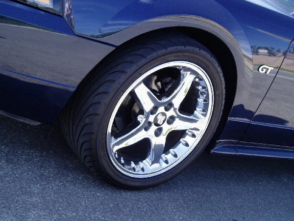

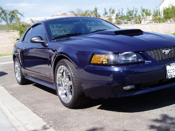

here is not so good pic of my front end. likeSomeone above me said, I have somewhat of agressive negative camber(-2.25), and you can tell how top of my tire is tucked in under fender. And I have lowered my car +2" on ffront, and all I get is some sriously tough looking front :hail2:
