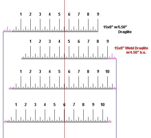

"I would buy 17x9.5 with 6" of backspace for the back and run 275 or 285 width tires"
"17x8 w/ 5.75" backspace for the front with a 245/45R17 tire

Here's the drawing. The red line is the mounting surface of the brake drum. The blue lines are the outer and inner limits including tire buldge beyond the rim edge. They are represented by the purple color. If you have any questions let me know.
If I were spendign my money I'd go with 245/45R17 and 285/40R17 BFG KDWS tires. They can be flipped side to side to enhance and extend tread life, have 400 treadwear and are OEM equipment on the 2003 blown SVT Cobra. They are a good tire. Cost is $131 for the 245 and $149 for the 285.

Tolbert67 said:
How much backspacing is there on the back with the quad shock in place??
9.5's will not fit under the fender withthe quads in place. They are not needed anyway. I took mine off 6 years ago and have NEVER notice a difference. Not at the drag strip or on the street. They're dead weight.
