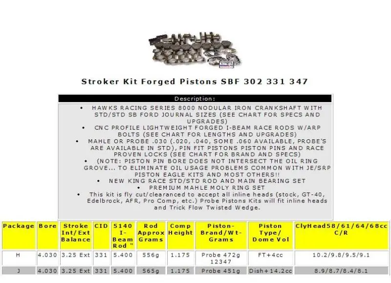

My Combo:
roller block Probed flattop 331 stroker kit 10.2:1 CR, romac ultra light balancer
Main girdle, Melling hv Oil pump, 7qt baffled pan
AFR 185cc #1422 58cc chambers with upgraded .600" valve springs
1.6 aluminum rr 7/16 stud, hyd lifters
TFS Stage 2 cam
Victor jr, holley 3310 750 vacuum secondaries manual choke carb,
3/8 fuel lines, Holley blue electric pump w/ regulator
rebuild stock distributor w/ petronix and 50,000 volt coil
1 1/2" 29" long headers 2 1/4" dual exhaust x-pipe 2chamber flowmasters.
I think I got it all, this will be mated to an AOD. Unsure about stall, but prob 2800-3200.
