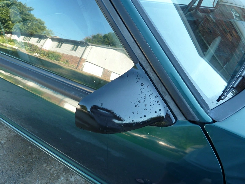

I used the googone (lol) to clean the paint up till it was mostly smooth. Then I gave it 4 coats of some gloss spray paint from autozone. Attached is the outcome. That is water on there and not giant drops of paint :-)

If you are looking for a glass like finish wait a week for the paint to cure then use a Meguirs #2 cleaning wax and rub it out. After you acheive the smoothnes you want use Meguirs liquid gold wax. :nice: I think you will be surprised at the outcome.

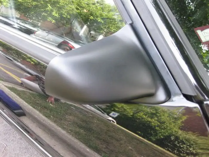

This is what I did....
-sanded down the worn out paint
-sprayed plastic primer
-sanded
-sprayed black trim paint
it's not a gloss look but it comes out extremely even and matches the rest of my flat black trim.

I think the flat black looks better in this situation as it matches the rest of the trim. If all your trim is gloss black, then go with gloss mirrors, but i think gloos with flat trim will make it stand out too much
