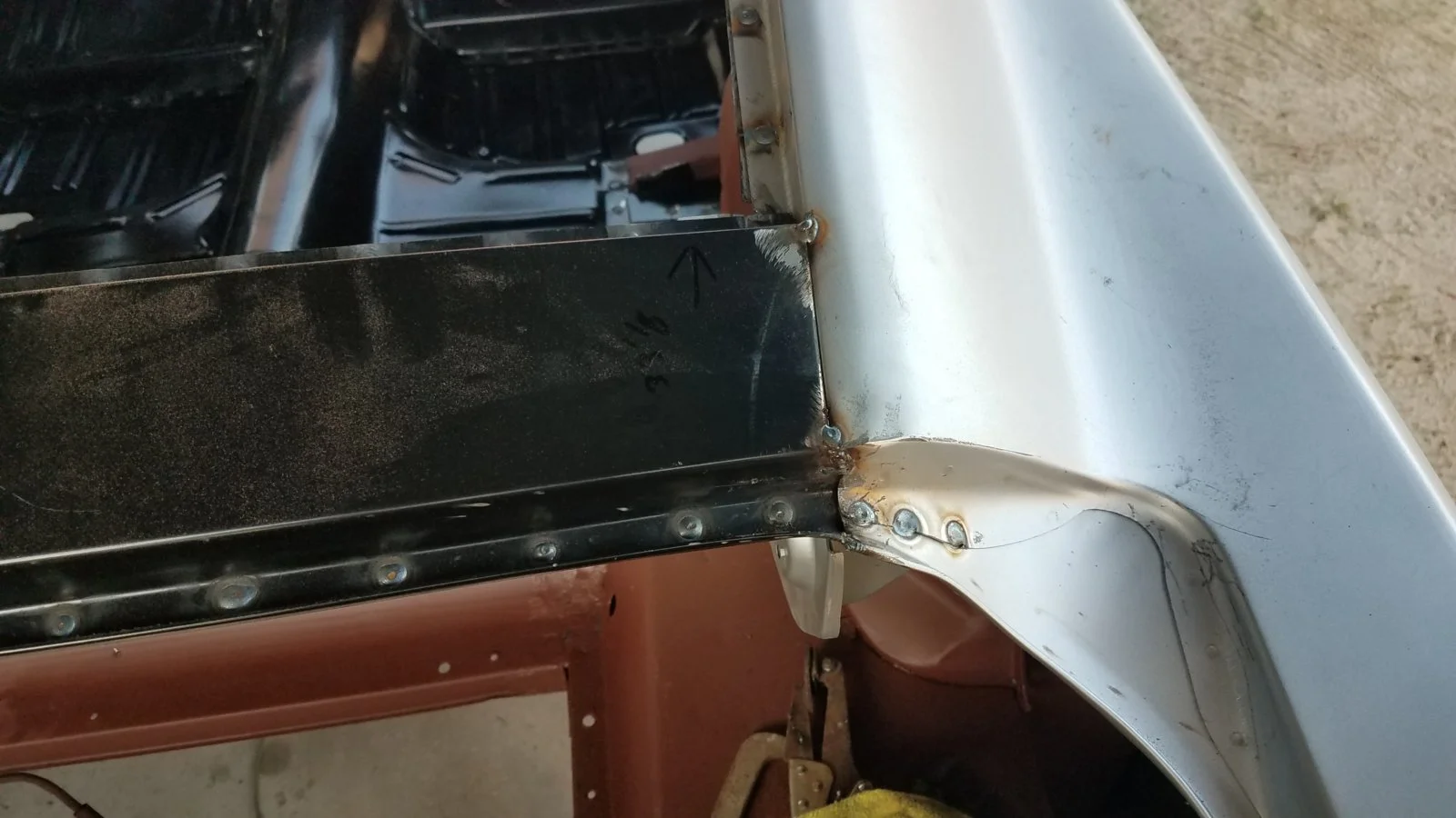

horse sence said:
Well ,it looks like pop and spatter figured it was do or die today ,the divider is in .now on to the tail panel
Do you have a set measurement for that divider or does it vary by car?
horse sence
12,530
8,596
233
Wile Coyote's stunt double
Jan 20, 2020
#84
  • Jan 20, 2020
  • #84
A set measurement ,but it can vary by 1/8
Reactions: Tmt1990

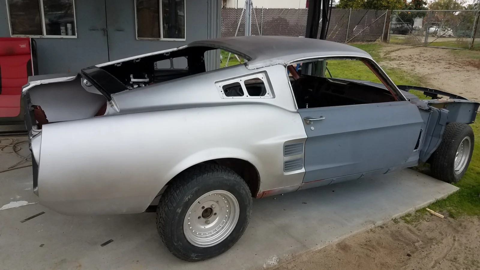

I didnt get get anything done today with deliveries and paying bills ,but i bolted in the vents to see how they fit and they fit very well

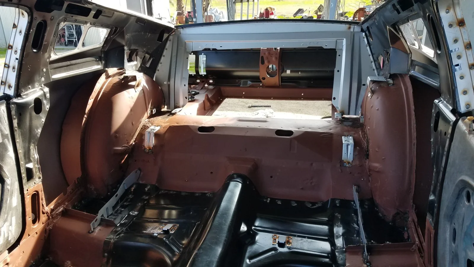

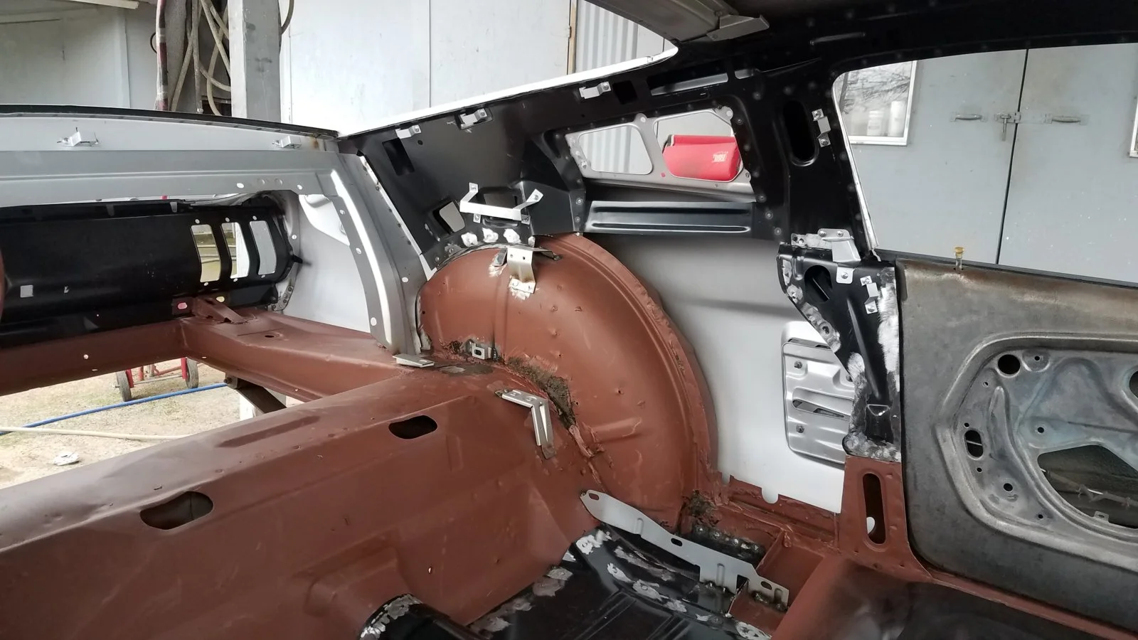

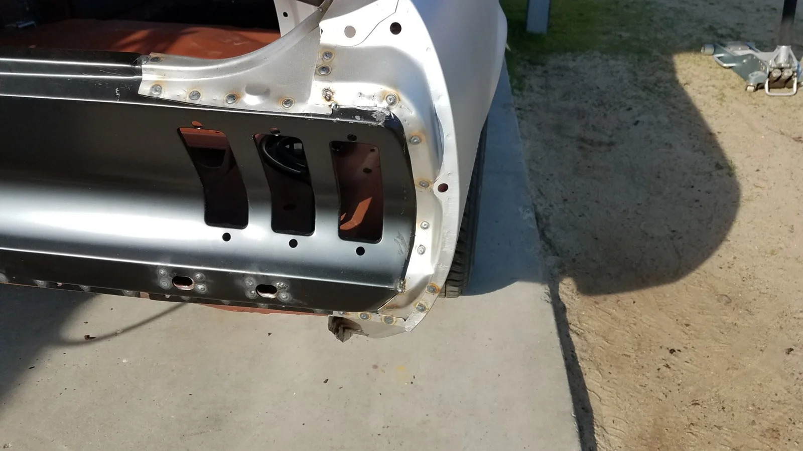

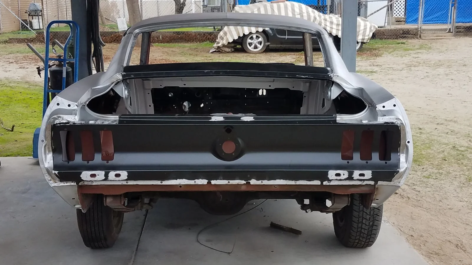

I got the tail panel to the quarters welded ,the trunk corners are in and i finished welding the window area . I still have to weld the wheel lips ,back by the rear valance and the roof to the rain gutters but it is starting to look good

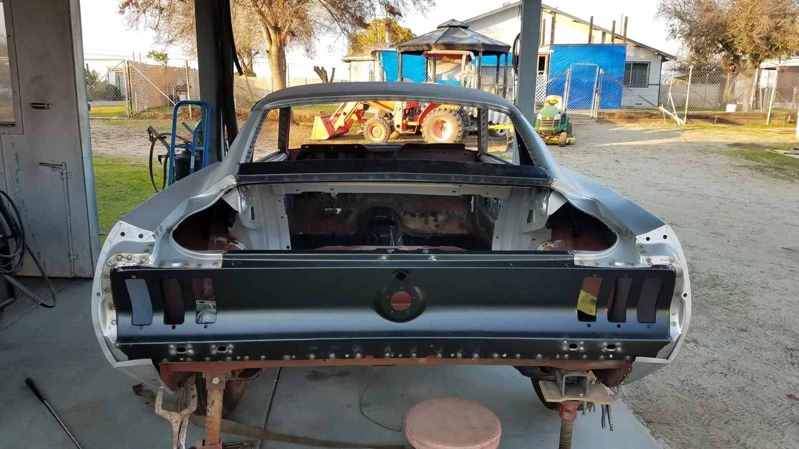

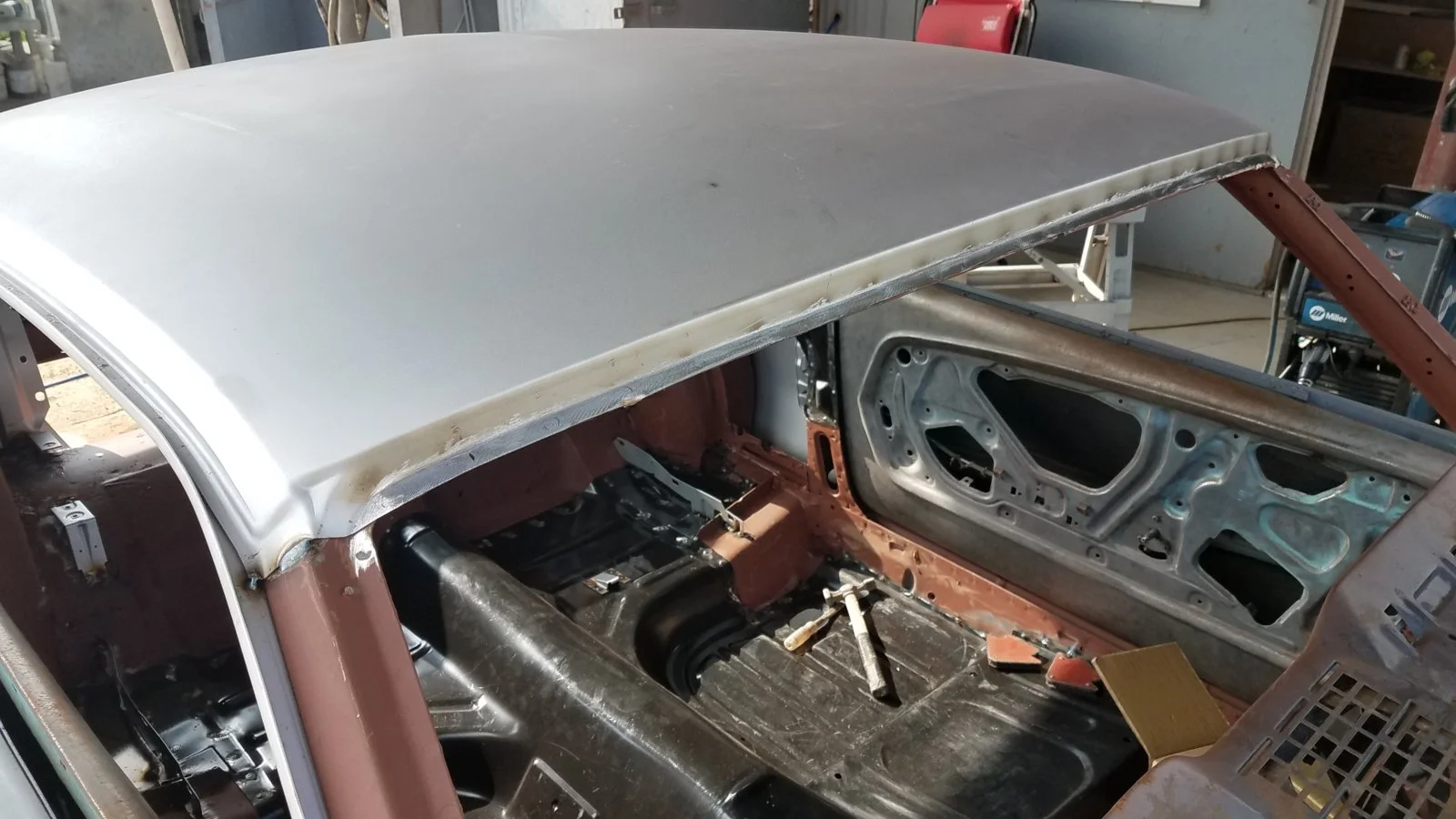

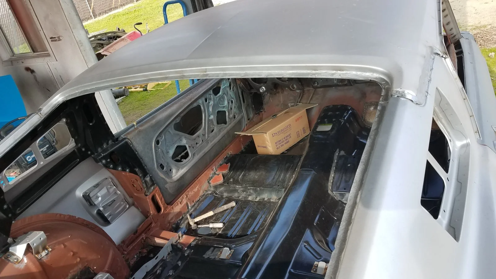

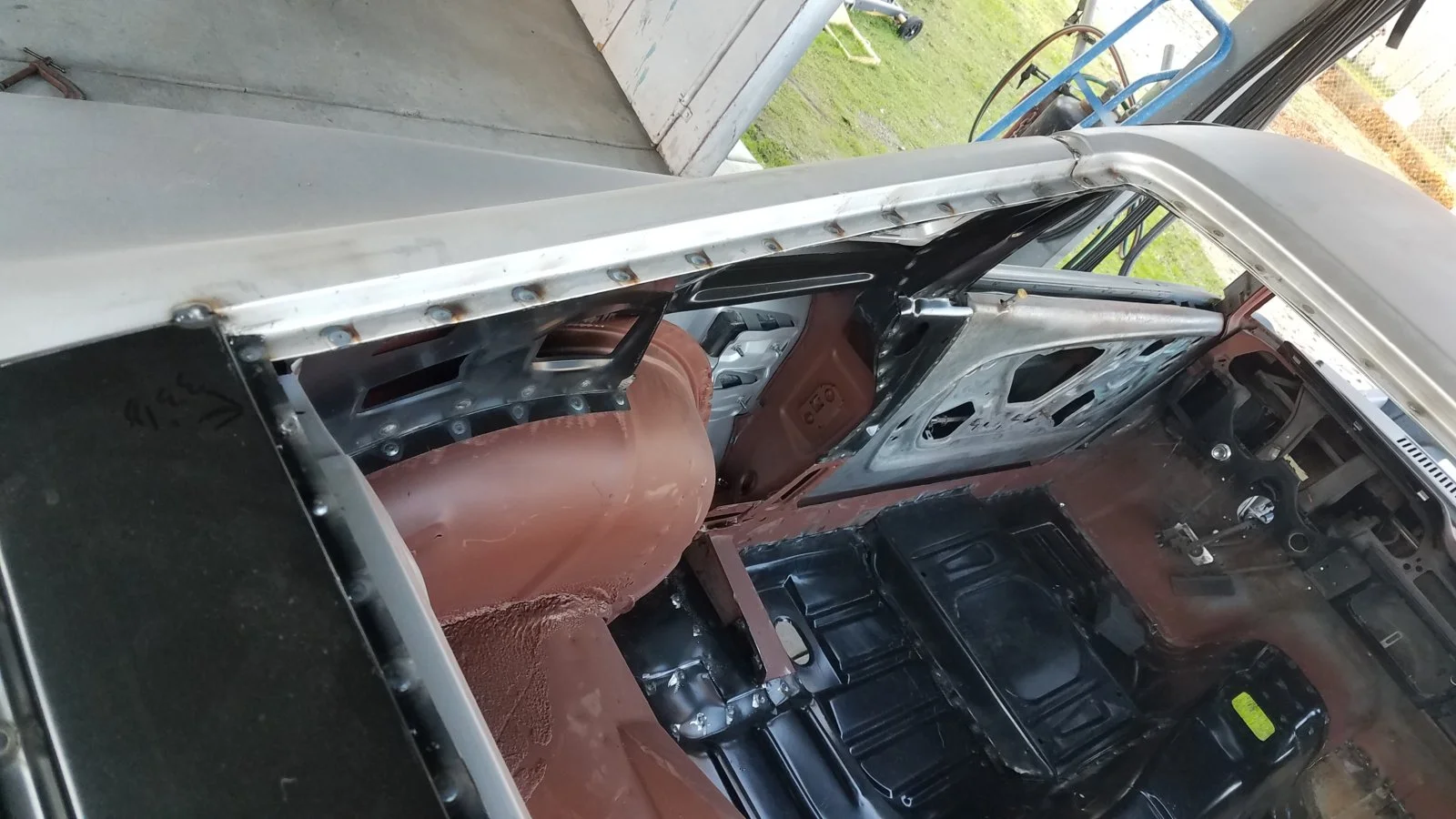

The back end is done ,except for grinding the welds . The roof is welded to the rain gutters and all the weld in brackets are in side . Still have to finish up the front toe board and patch the quarter window holes in the door jamb and it is done ,and it is back on the ground

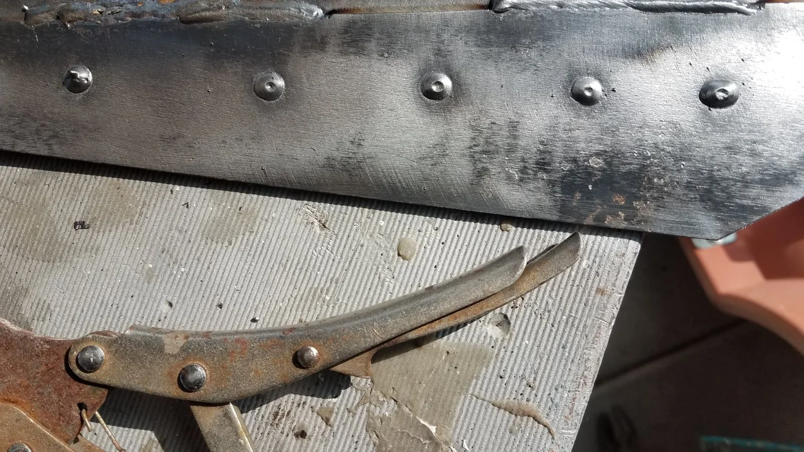

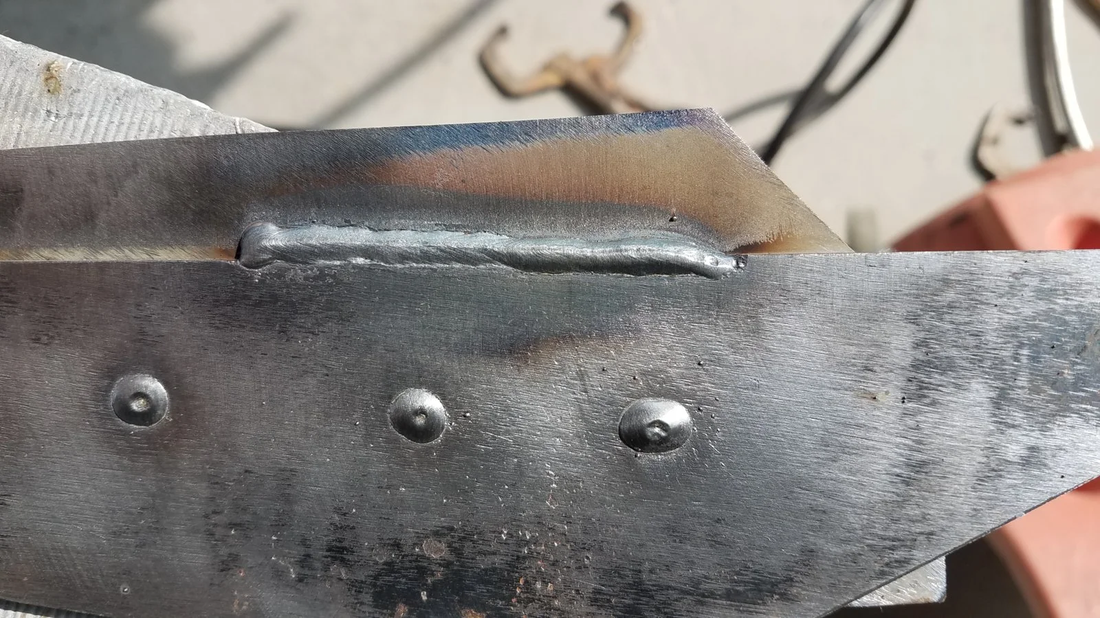

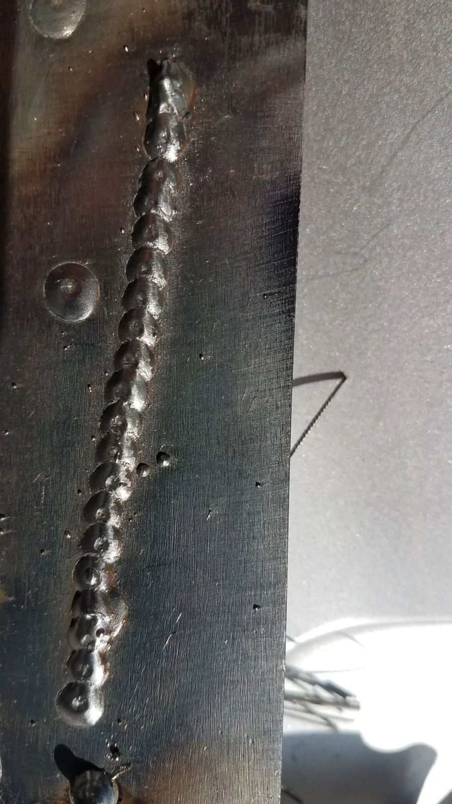

I got some of the welds ground .

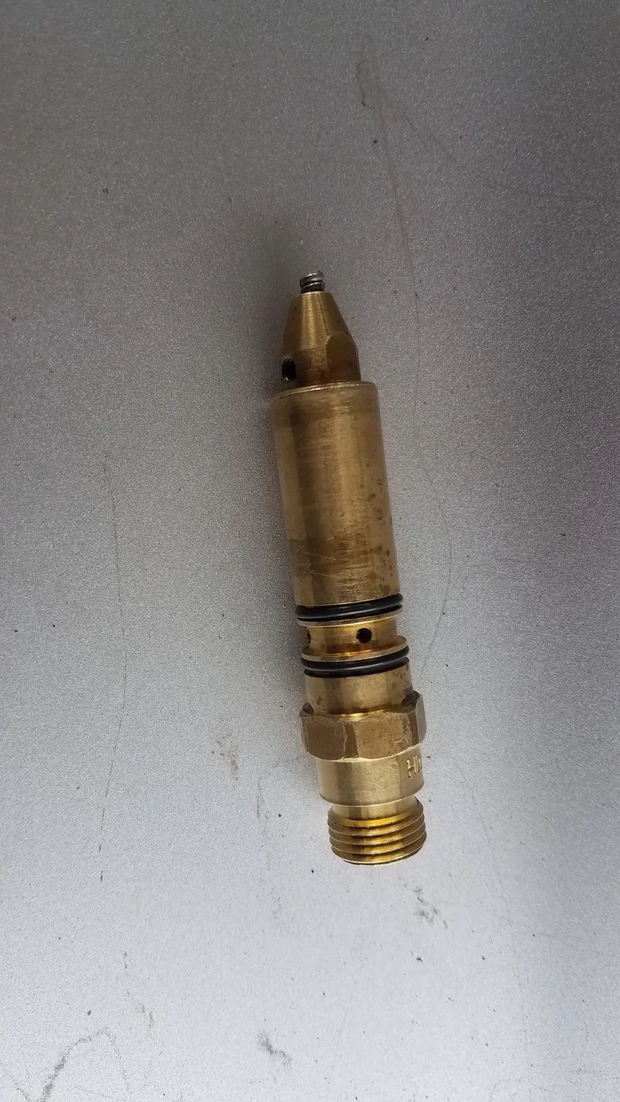

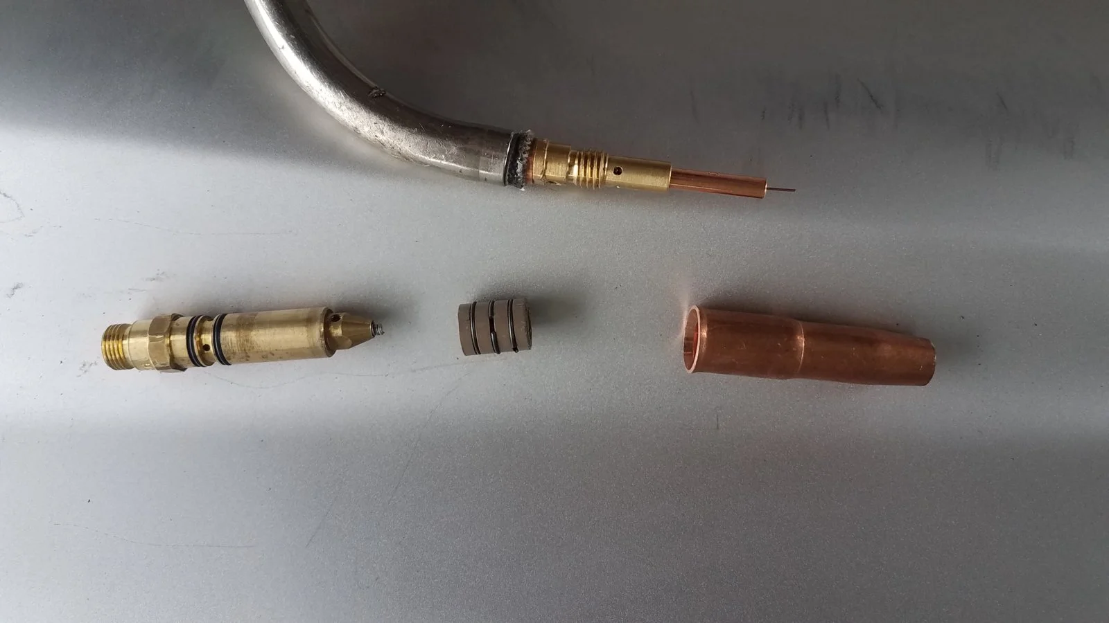

Bought a new liner ,tip ,cone and new defuser for my mig . $50 for all including a box of new tips . It didnt want to supply gas to the gun at first ,i dont know what the problem was but after taking it all apart 4 times it finally works . Now i have to play around with the wire speed but it is making a pretty good plug weld . One decent weld but i cant see through my helmet ,have to get a lighter lens

Still not where i would like it ,but i can stitch weld now so thats good

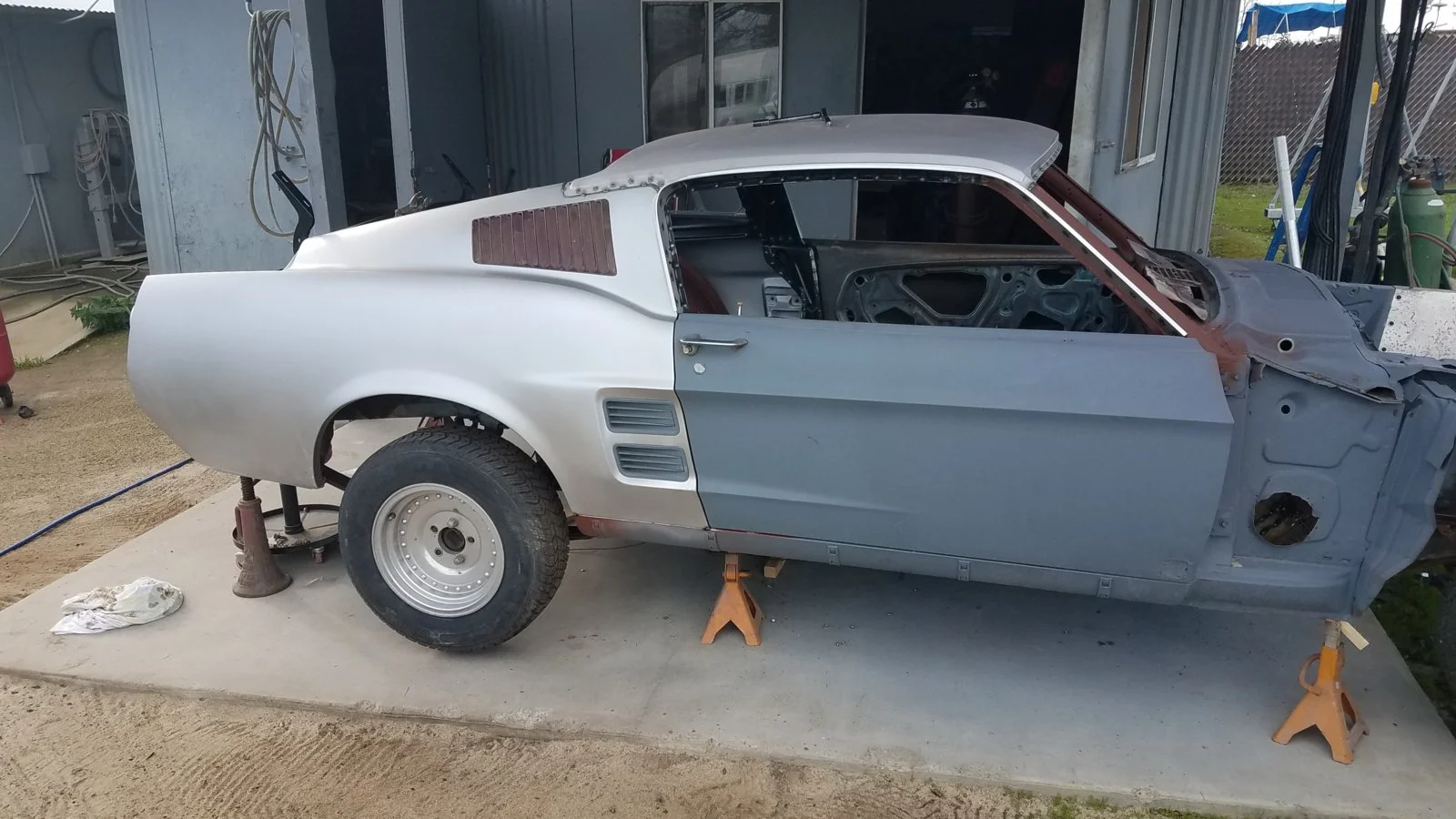

This one is done ,probably head out to the paint shop next week .

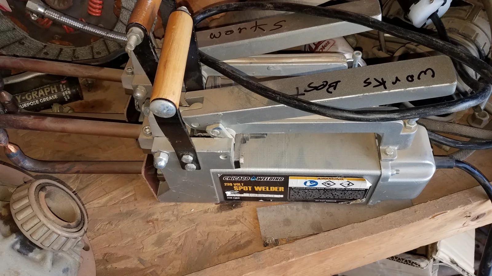

A little late but , i took all three of my spot welders apart, cleaned all the connections and managed to get all of them working again . This will make the next one a whole lot easier to build,and a lot less grinding . Should be starting on it Saturday
