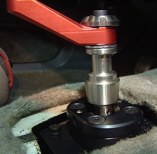

a few pics of the install:
attachment.php

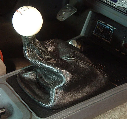

WOW that looks beautiful, do you have any pics of the boot on? why does it look like the shift knob is only on half way? is that how it is? anyway thats the only thing on my christmas list this year, :banana:
EDIT: just saw that picture ;)

Question. Being that the handle does not bolt on in the regular way, does that mean you can angle it towards you? If that is the case, that has to be a perfect design. It would allow the driver to custom fit his (or her) shifter to their own size and preference. Do they have them for the TKO or T56? How much?
Yes the handle can be angled any way you like. 360 degree adjustability. They do offer the shifter for T56.

Seems a shame to cover it all up with the boot!
LOL that's exactly what I think of most shifters. Why make these things "look cool" and have differently-colored powdercoated pieces or polished, ect. when you don't see a single bit of it when all is said and done?

actaully in our case the anodizing has a purpose...
1. the black base is actually a type 3 hard coat anodize to avoid the raw aluminum from galling when the pivot ball rocks back and forth which can make the shifter feel rough and notchy and also contaminate the grease.
2. the blue and red handles are anodized strictly for identification purposes. both for us and our cusotmers. that way if i get a cusotmer calling with our shifter and says he wants a shorter throw or longer handle for better vreach i can find out for sure which handle he already has by just asking what color it is. :nice:
still a shame to cover it up though :flag:
